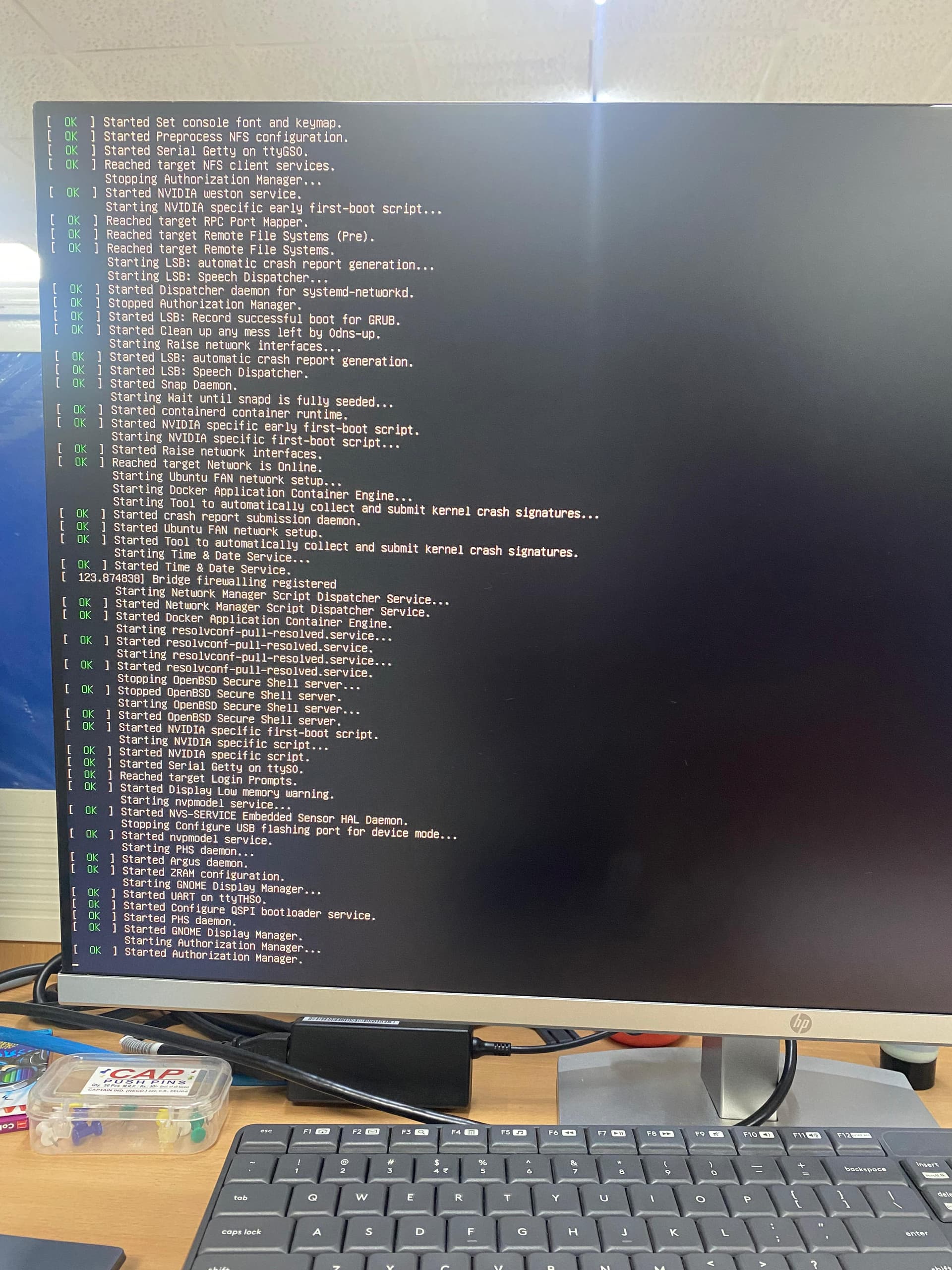

this came up and no GUI config for resizing root showed up and after that…
this came up and login came up. with new username

Could you share your full dmesg from uart?
or share your flash log from sdkmanager.
