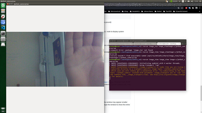

**Author:** ![fatih.ozkan](https://sea2.discourse-cdn.com/nvidia/user_avatar/forums.developer.nvidia.com/fatih.ozkan/32/16341_2.png) [@fatih.ozkan](https://forums.developer.nvidia.com/u/fatih.ozkan)\
**Post date:** [January 15, 2021, 10:08am UTC](https://forums.developer.nvidia.com/t/ros-and-raspberrypi-camera-v2/165885/8 "2021-01-15T10:08:20Z")
</div>
![image](https://global.discourse-cdn.com/nvidia/original/3X/f/7/f71944e9c0b37ec8454a8741186a0175f3e4649a.jpeg)
I am able to use camera with jetbot\_camera node. Appreciate that :D
But now i am confused about how can i use my motors. I think i can’t use all package(jetbot\_ros) with my rc car. It is not capable with it. At least i am using PCA9685.
Now what should i do now? Finding a PCA9685 ROS node and using it with jetbot\_camera node . Am i right?
