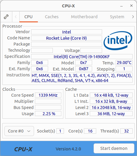

my pc spec:
OS: ubuntu 22.04
CPU: -9-14900KF
GPU: 4080 Super
storage: 500 GB

Hi @amr.amrinal
Yes, your desktop meets the good requirements.
I’m concerned that what we have might not be sufficient. In our documentation, we wrote:
In particular, we recommend an “ideal” machine in the Isaac Sim requirements.
