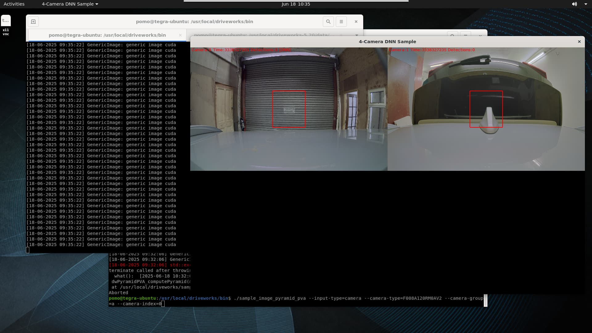

There is an issue when the sample is tried to launch with live cameras, the documentation mentions that the sample can be executed so as.
There is change in camera parameters being accepted to the sample via SimpleCamera framework, which is old parameter string compared to the new usage from sample_camera.
Ive encountered the following error to launch the sample with the old camera params which is supports.
Error String
[13-06-2025 11:03:12] std::exception thrown: Setting OffsetPointer base with invalid device pointer
terminate called after throwing an instance of 'std::runtime_error'
  what():  [2025-06-13 12:03:12] DW Error DW_FAILURE executing DW function:
 dwPyramidPVA_computePyramid(&m_pyramidOutput, inputImage, 0, m_pyramidModule)
 at /usr/local/driveworks/samples/src/imageprocessing/pyramid/main.cpp:318
Aborted

Dear @ashwin.nanda ,
Is sample_camera working with same module?
dear @SivaRamaKrishnaNV please check this screenshot, which shows a dnn application running adaptive to sample_camera:
Dear @ashwin.nanda,
Do you have other camera module to test? I don’t see issue with my camera module with same command(camera-type is different).
dear @SivaRamaKrishnaNV I do have other camera module however want to use the 4 Entron Cameras at the moment. Please check my PM on this.
It is known issue with Entron camera when using image pyramid PVA sample.
