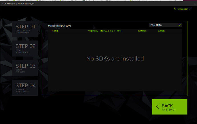

I already ran SDKManager on Ubuntu22.04, why are there no SDKs available also?
Pet
Your screenshot told us you are using ubuntu24.04 but not 22.04.
from table, 24.04 is ok for flashing.

I installed SDK successfully, and the last also indicates installation is sucessfully. But when i click repair/unstall, there is showing No SDKs are installed. Is it normal?
Peter
local jetson_release also showing Jetpack missing.
Please run below commands on your AGX Orin.
sudo apt update
sudo apt install nvidia-jetpack
@WayneWWW , Does SDKmanager read back the installed modules when the target baord is connected?
Peter
Does your “installed modules” mean the libraries (CUDA/CUDNN/TensorRT …etc) installed or you are talking about the L4T version installed?
i mean all including L4T. This tab is for repair/uninstall, so i think it should list all modules which are installed in the target.
No, this is not supported.
