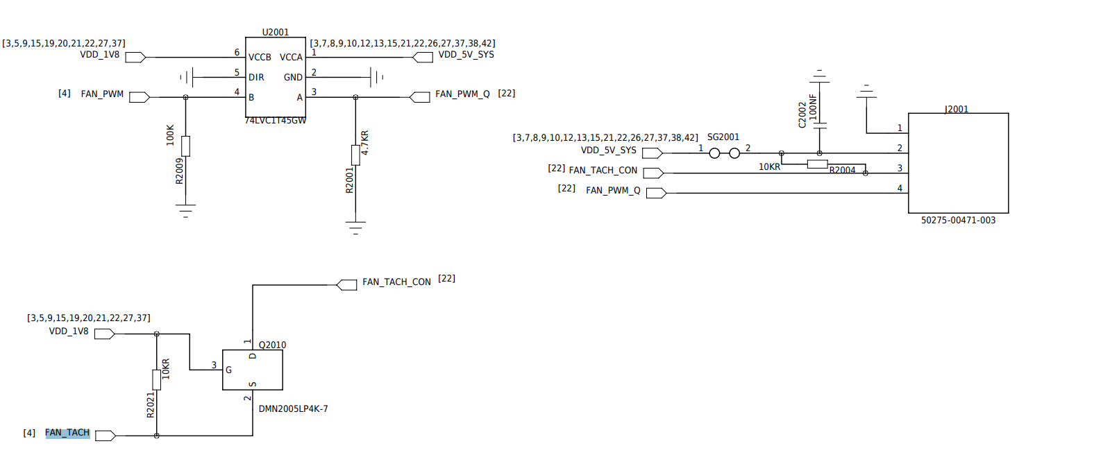

Do you ever read the schematic of your own custom board design here?
It seems has something that do not match to what you wrote to your device tree.
For example, you give GPIO Q,2 to the cd-gpios of sd controller. CD-gpio is the card detection pin to detect the sdcard.
However, your board schematic shows the Q2 pin is used by FAN. Totally not connected to the sd controller.
As I mentioned earlier, we connected the development board and the card slot with a wire. We connected this pin, and it can detect whether the sdcard is inserted (0v if it is inserted, 1.8v if it is not inserted).
Ok, so now you have something that is different from the schematic. Can you directly share a finalized version to us so that our hardware guy can comment?

We use the wire to connect the board and the card slot and did not change the schematic.We have used VDD, GND, G.2 and these pins in the picture, which are connected directly with wires.
