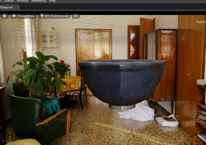

When using normal maps in Omniverse Create (2021.1.0), seams may be visible at the boundaries.
This may be resolved with MikkTSpace.
sample file(cyawan.usdz).Please unzip and use this.

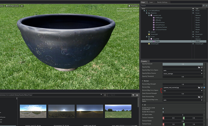

The normal map in the material texture slot needs to be set to colorspace RAW
Actually, looks like in UsdPreviewSurface, that colorspace is not working. I will look into it.
Meanwhile, using OmniPBR and setting the colorspace works
Thanks for the confirmation.
I have confirmed that specifying colorspace RAW in the Normal Map in OmniPBR works well.
