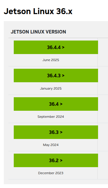

I will need to public sources (Driver Package (BSP) Sources) for it… for the kernel. where can I download them? they are not in the list
You can download the r36.4.4 source code for r36.4.7
Thank you
