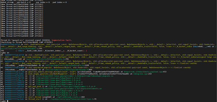

  2. gdb tracking:

  2. From the stack, it crashed in generate_dsmeta_message_minimal of opt\nvidia\deepstream\deepstream-7.0\sources\libs\nvmsgconv\deepstream_schema\dsmeta_payload.cpp, which is opensource. you can add log to check which line cause the crash.

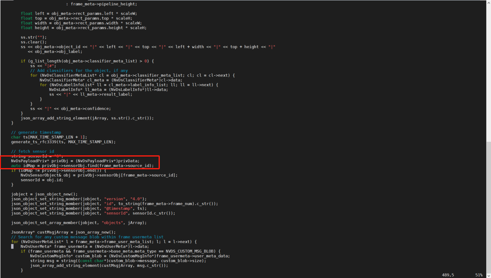

  2. The reason is that privData is NULL in function generate_dsmeta_message_minimal(void privData, void frameMeta)**. If privData is NULL,how to get sensorId in generate_dsmeta_message_minimal?

from your configuration file, you did set config for nvmsgconv. you can add log in opt\nvidia\deepstream\deepstream-7.0\sources\libs\nvmsgconv_audio\nvmsgconv.cpp to check.

Thank you, it is solved by setting config for nvmsgconv.
