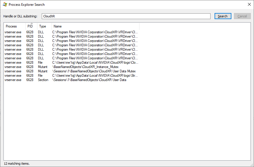

I have also used process explorer and the files seem to be there. Is there something simple I am missing here?

The issue was I did not use L"< stringpath >" on the call:
HANDLE hUserDataFile = OpenFileMapping(FILE_MAP_READ, FALSE, LPWSTR(L"CloudXR User Data")); it need to be a widechar literal

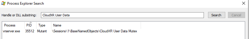

For me I can find only “CloudXR User Data Mutex” in Process Explorer… Should I do something else to see “CloudXR User Data” file?
In the server App I could not find it either

Hi Veronica,
thank you for your reply, the problem is already solved :) I just didn’t know that I should send the “cxrInputEventType_Generic” event. I thought that the file will be just there when I start the connection
