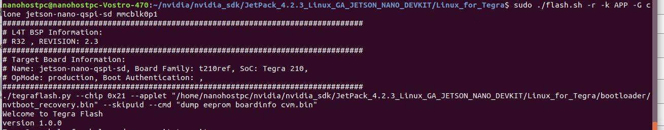

Setting Up Cross-Platform Support
I’m tried
sudo ./flash.sh -r -k APP -G mmcblk0p1
I follow this description-Setting Up Cross-Platform Support-
https://docs.nvidia.com/jetson/l4t-multimedia/cross_platform_support.html
Can you help me?
nanohostpc@nanohostpc-Vostro-470:~/nvidia/nvidia_sdk/JetPack_4.2.3_Linux_GA_JETSON_NANO_DEVKIT/Linux_for_Tegra$ sudo ./flash.sh -r -k APP -G clone jetson-nano-qspi-sd mmcblk0p1

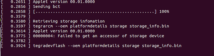

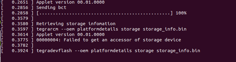

[ 0.3580 ] Retrieving storage infomation
[ 0.3597 ] tegrarcm --oem platformdetails storage storage_info.bin
[ 0.3614 ] Applet version 00.01.0000
[ 0.3775 ] 00000004: Failed to get an accessor of storage device
[ 0.3782 ]
[ 0.3924 ] tegradevflash --oem platformdetails storage storage_info.bin
hello neuezeal,
you don’t need to clone a system image for setting up cross-platform support,
please revise topic tittle,
if you’re asking the feature for Nano SD card cloning, we’re currently don’t have plan to enable that.
BTW, please also check Topic 82908 for an alternative way to backup system image.
thanks

hello neuezeal,
sorry, did not check carefully that you would like to cross-compile on Host ubuntu.
since there’s issue to clone Nano SD, could you please try to build samples on Nano itself.
or, if you had TX1, you could setup an environment for deployment due to they’re sharing same chip family.
thanks
Also know that if your filesystem is on SD, then you can use dd directly on the host to copy the partition. This provides the same exact image as does the raw clone image, and can be loopback mounted.
