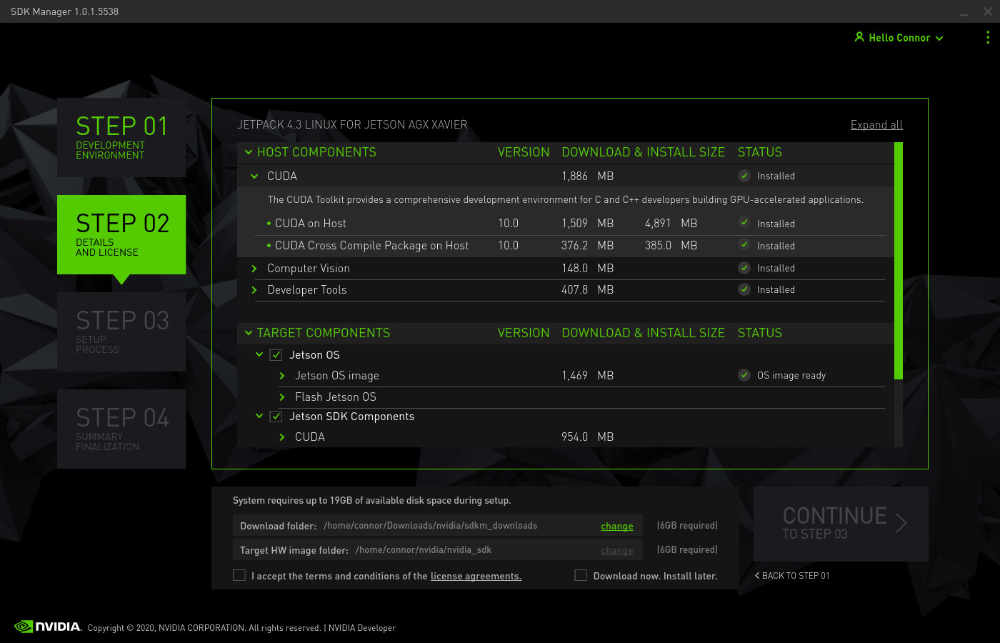

I’ve just installed JetPack 4.3 on my host PC (Ubuntu 18.04) and flashed my Jetson AGX. The next thing I want to do is setup my PC and AGX so that I can code on my host PC and then cross compile to the AGX.
Are there steps/instructions for doing this? I read here (https://docs.nvidia.com/cuda/nsight-eclipse-edition-getting-started-guide/index.html) that NSight should be installed with the NVIDIA CUDA toolkit, however, when I try running “nsight” on the host pc I get "Command ‘nsight’ not found…install with…etc’.
From the SDK manager the host components that were installed were:
  • CUDA -
    CUDA on Host
    CUDA Cross Compile Package on Host
  • Computer Vision -
    OpenCV on Host
    VisionWorks on Host
  • Developer Tools -
    NVIDIA Nsight Graphics
    NVIDIA Nsight systems
    DevTools Documentation
Do I need to also install the nvidia-cuda-toolkit on my host PC? Is this not part of the SDK manager downloads for some reason?
I’m very new to all of this so I may just have missed something basic…
Thanks for the help!
It’s required to install the host CUDA-toolkit from the JetPack4.3 for the compatibility.
This can be found in the sdkmanger in the HOST section.
The CUDA path may not be added into the environment parameter.
You can also try this command to specify the nsight location.
/usr/local/cuda-10.0/bin/nsight

I can see nvcc in
How should I edit what is in (https://docs.nvidia.com/cuda/cuda-installation-guide-linux/index.html) section 7 to add this to my PATH? I have followed the instructions in sections 7.1.1 but “nvcc --version” still does not work.
Edit3: Adjusted PATH env variables…all seems to be working now.

Thanks. The issues ended up just being related to setting up the path environment variables so that I could find nsight/nvcc etc.
