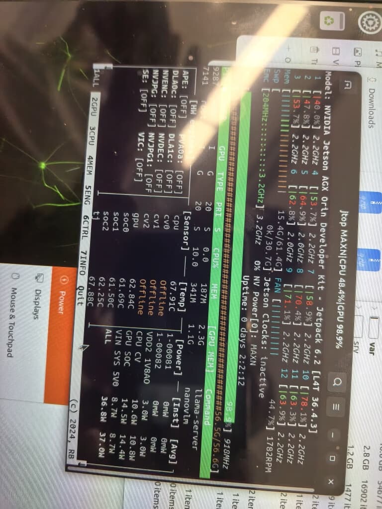

We have integrated the Jetson Orin 64GB Devkit into our product for algorithm execution, housed within the product’s external casing. We’ve encountered an issue where a total of 6 units have experienced unexpected power-offs during testing within the past month, after which they can resume operation upon repowering. The issue is difficult to reproduce; at its most frequent, it occurred 3 times within an hour, while ordinarily, it might happen occasionally over several days. The testing environment is indoors and air-conditioned. Please refer to the screenshot for resource utilization: GPU is at 98%, CPU is around 50-70%, and the power mode is set to maximum performance. We have already ruled out insufficient external power supply capability (our own board can supply up to 164.5A) and connectivity issues. Due to the sporadic nature of the power-offs, relevant logs were not saved previously. The relevant system configuration is shown in the figure.
Before the power loss, the following information was seen in the machine’s kernel log. It appears to be related to thermal issues.
Check how to locate the issue, and if it is caused by high resource usage leading to overcurrent or temperature problems that trigger hardware protection, what are the safety usage thresholds, and how to design for safe operating conditions. The syslog before shutdown has been uploaded and can be used for detailed analysis.

May I kno which JetPack SW you’re using?
JetPack 6.2
please use uart console to monitor and then reproduce issue and share the full log from uart and also tegrastats result.

您好,我们在使用过程中,用JTOP界面观察到了发现了OC的告警,但没有触发关机,资源情况如图所示。想咨询一下OC如何理解,以及影响后果。我的理解,OC的产生条件是当系统负载过重,2个采集电流的传感器INA3221(第一个采集CPU、GPU、总5V;第二个采集DDR,IO,VAO)采集到的系统总瞬时电流 超过了这款开发套件 最大的瞬时功率TDP(65W)限制,会报出来的,会引起硬件节流降低频率,但不会导致关机。有没有可能是功率严重超过,导致系统的软件风扇控制、软件降频、硬件降频、软件关机等策略没有响应的时间,直接导致硬件关机。
HI,
我們前面跟你索要的資料就是要確認你們問題發生時的溫度還有功耗狀況.
這些資料沒有給的話說實話沒有辦法判斷.
你對OC throttling的理解是對的, 這部份只會造成thorttling但不會造成關機. 會造成關機比較有可能是過熱的部份.
