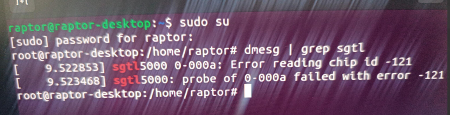

  1. In the dmesg log we are getting sgtl - chip ID error. Any idea why this error might be?
  2. we are using I2C2 for connecting the SGTL codec. Pls let us know the correct address for this.

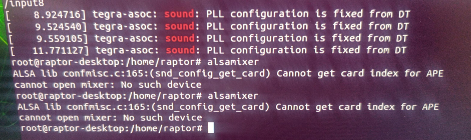

  1. Also now we are getting error, whenever we execute ALSAMIXER command. Let us know what might be the issue..

Lets go step by step. After finalising the i2c holding the codec, Please add codec node as per Audio Setup and Development — NVIDIA Jetson Linux Developer Guide . Your entry seems different from the one mentioned in the guide
<i2cdetect -l> lists all i2c buses
scan each of them <i2cdetect -y> to find the i2c that has the codec at 0xa..the relevant i2c shall have a UU entry if connected to sgtl codec at address 0xa
CONFIG_SND_SOC_SGTL5000 is sufficient for sgtl5000 audio codec.
After flashing check if sgtl driver is available on target via
lsmod | grep sgtl5000
Further, put a print statement in the probe of sgtl driver to see if its getting probed. The log can be checked for in “dmesg”
cat /sys/kernel/debug/asoc/components
Above should list SGTL if probing was succesful. Please try above steps and share your observations
Regarding dtsi, tegra234-p3768-0000.dtsi, tegra234.dtsi, tegra234-p3768-0000.dtsi are the relevant files. It as pointed in this section( Audio Setup and Development — NVIDIA Jetson Linux Developer Guide ). Hope you are rebuilding dtb and flashing. Give a try and let me know

Also one more query:
As we are getting SGTLCodec5000 Chip ID error, does not this prove that probe of the codec is happening? is it really require to change the driver code to verify the probe?
Yeah not necessary since you are getting a print from the driver. But can be used for debugging codec registration. Please test with appropriate DT node when you get the setup
