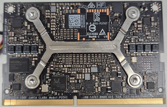

We are using several Orin NX 16 modules purchased at different times together with our custom carrier boards.
For power control, we use the LTC2955 controller.
When power is shut down at the module’s request, the Shutdown_req signal goes to the Kill input of the LTC2955, which then disables Power_en.
We have found an issue:

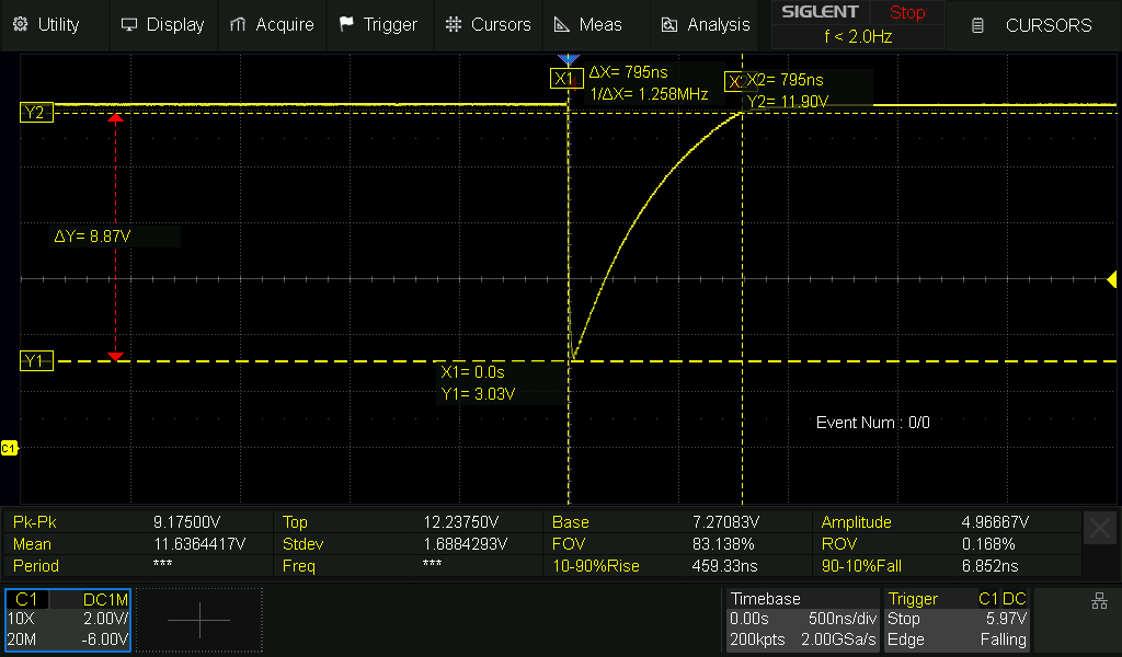

  • On some modules (photo 4), the duration of the Shutdown_req pulse is normal square form about 10 µs to 0V, and the controller triggers correctly, shutting down the Jetson.
  • On other modules (photo 1), the duration of the Shutdown_req pulse abnormal form is less than 1 µs only to 5v and the controller does not trigger, so the Jetson is not shut down.
Also we tested Shutdown_req with software “poweroff” on original carrierboard - have a same problem, so we think that the promblem with Shutdown_req pulse is on some versions of modules.
Photos of the modules, waveforms, and schematic are attached.

We think that the problem is with some versions of modules.
Please refer to Jetson Orin NX Series Modules - Hardware Errata Log in | NVIDIA Developer
to help check if your modules are affected.
Thank You!
