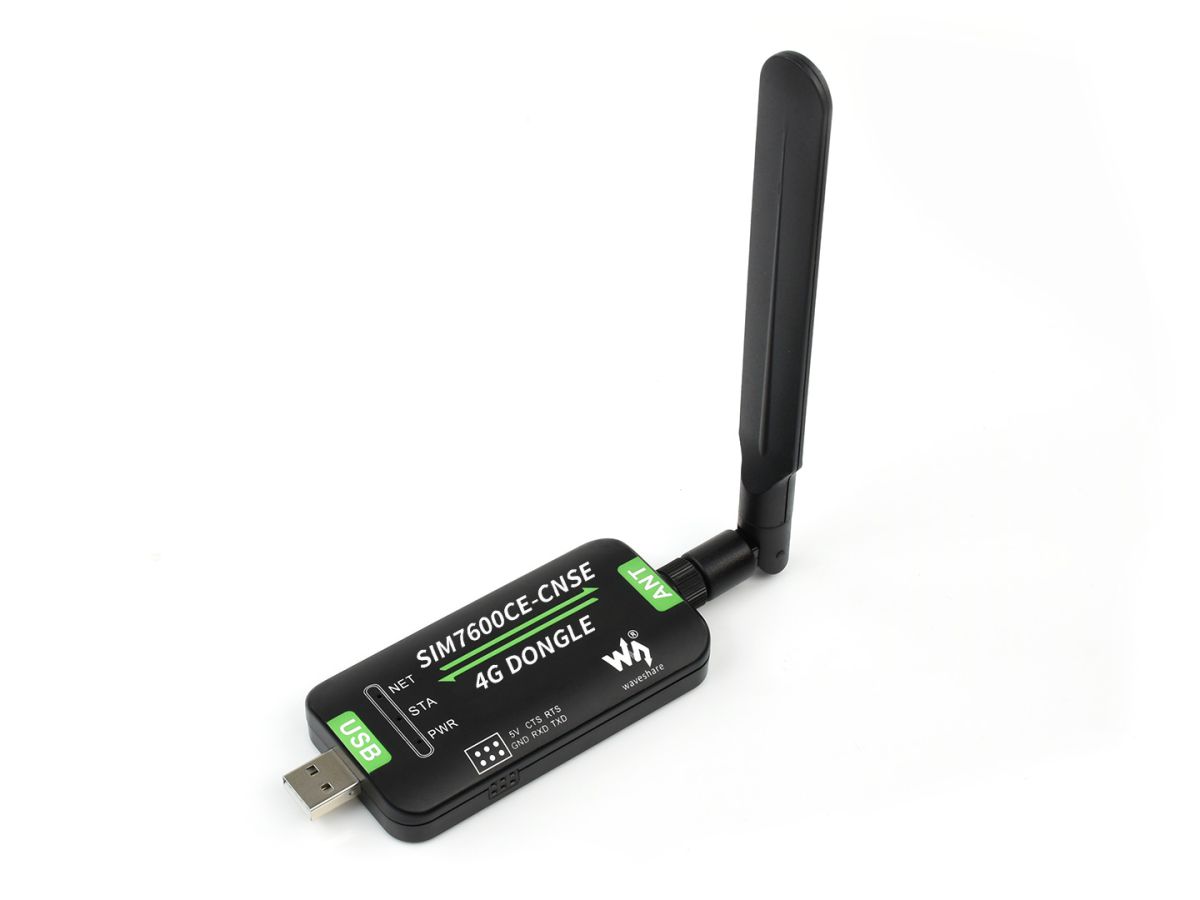

SIM7600G-H_4G_DONGLE installation on Jetson nano
I followed,= below link to install 4g dongle driver but it failed to build.
here is the error while building :
nvidia@nvidia:~/simcom_wwan$ sudo make
[sudo] password for nvidia:
**make -C /lib/modules/4.9.140/build SUBDIRS= modules **
make[1]: *** /lib/modules/4.9.140/build: No such file or directory. Stop.
Makefile:6: recipe for target ‘default’ failed
make: *** [default] Error 2

L4T i am working is : 32.3.1
Pelease help me to resolve this
