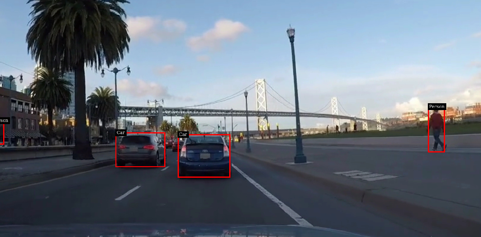

Hi, Im running deepstream-user-metadata-app in sample_apps directory. When i set interval value more than 0 it show like interrupted frame.
How can i make it smooth ? similarly when i set interval value equal 0. Thanks a lot.
I can’t find a configuration to do that with DeepStream elements, but you can do it with a custom element. This element would save a reference to the last buffer with a valid object meta and copy it to the following buffers using nvds_copy_obj_meta_list.
