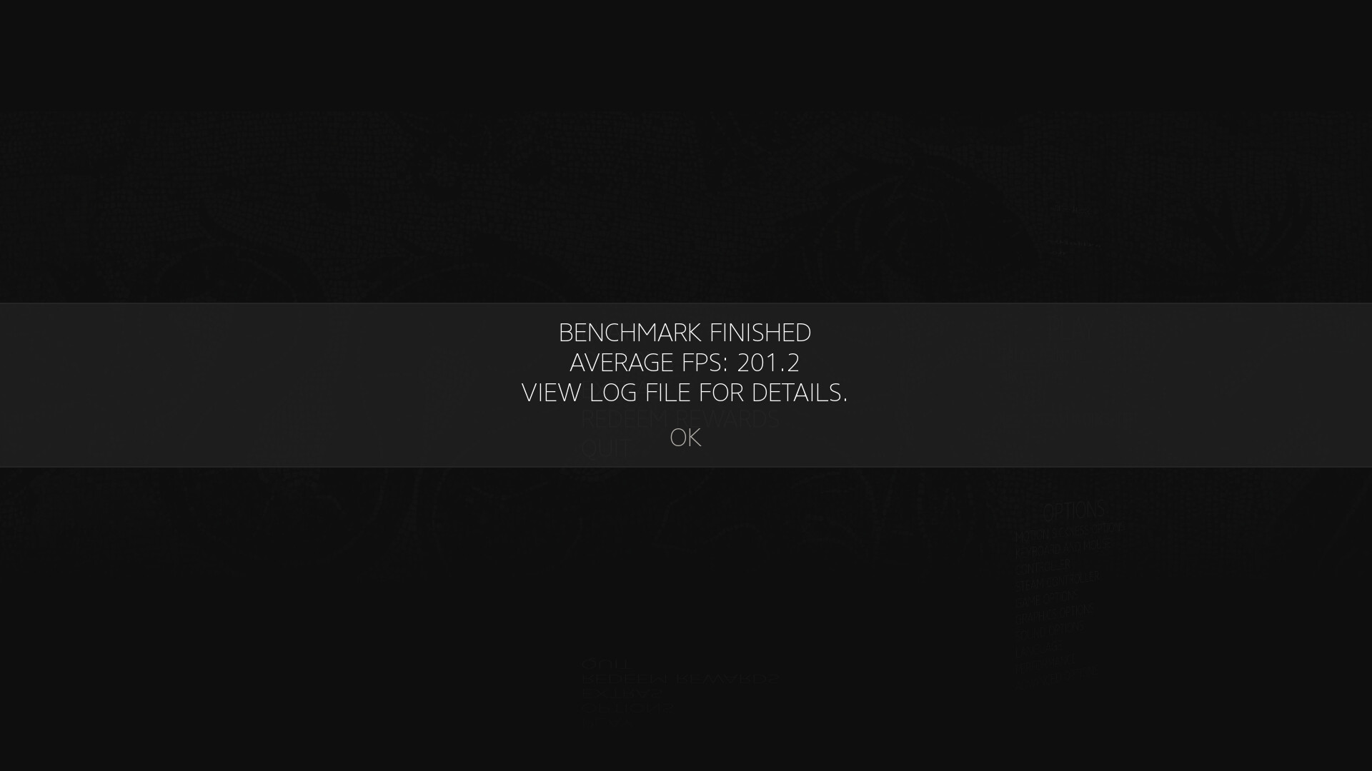

[Solved - Update to 381.22] The Talos Principle running in Vulkan Segfaults with GTX 1080 and the 381.09 drivers on Ubuntu 16.04
As the title says. It doesn’t segfault with 378.13.
Same happens with the Mad Max Vulkan beta.
PS: Both these driver versions were installed from the .run files.

Can you share segfault details and backtrace? What was the previous stable driver for you which don’t have this issue?
As I mentioned in the original post, this doesn’t happen with driver version 378.13. The problem with 378.13 is that I can’t install it on the 4.10 kernel, which I’m currently using.
Here’s the full Log from Talos Principle: Talos.log - Pastebin.com
Relevant excerpt:

Both The Talos Principle and Mad Max finish the benchmark runs without segfaulting, using their respective Vulkan renderers and driver version 381.22. I’m assuming it was a driver issue, after all?
Also, I now get over 200FerPS in Talos with Vulkan:
