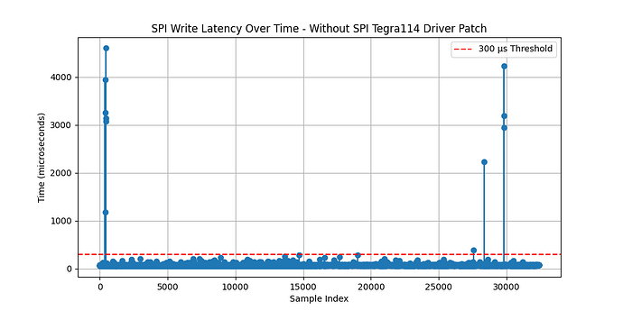

I am working with SPI communication on the Jetson AGX Orin and am encountering variability in TX times when sending data via SPI. While most transfers complete in approximately 100µs, I frequently observe significant outliers, which can impact applications requiring fast and consistent communication. I’ve attached a graph illustrating this variation.
I reviewed the Orin Jetson Series Pinmux Config Template to identify potential optimisations, but couldn’t figure out any obvious changes in order to make progress. Additionally, I have tested with Jetson clocks enabled to ensure maximum performance, which has noticeably improved results compared to when they are disabled (the graph attached reflects that).
I’d appreciate any guidance on improving SPI transfer consistency. Are there specific configurations, kernel parameters, or NVIDIA documentation that might help us reduce these outliers? Any relevant examples or insights would be greatly appreciated.

I’ve modified the spidev_test.c code from this repository to print the time it takes for SPI transfers (specifically the write time), and I keep getting values around 300 microseconds, with jitter present as well. Below is an example output:
$ sudo ./spidev_test -D /dev/spidev0.0 -v -p "TestTransferTime"
spi mode: 0x0
bits per word: 8
max speed: 500000 Hz (500 KHz)
SPI write took: 306 microseconds
TX | 54 65 73 74 54 72 61 6E 73 66 65 72 54 69 6D 65 __ __ __ __ __ __ __ __ __ __ __ __ __ __ __ __  | TestTransferTime
RX | FF FF FF FF FF FF FF FF FF FF FF FF FF FF FF FF __ __ __ __ __ __ __ __ __ __ __ __ __ __ __ __  | ................
Even with higher frequencies (10 MHz, 20 MHz), the results remain the same. I am not testing loopback feedback—there’s nothing connected to the MOSI and MISO pins, so I am only measuring the transfer time itself. Is this method appropriate for testing?
Since I’ve encountered the same jitter and latency issues with both Jetpack 5.1 and Jetpack 6.2, I wanted to ask if the patch mentioned in this forum post would still be applicable to my setup. If so, could you provide some instructions on how to apply it?
Thanks again for your support!

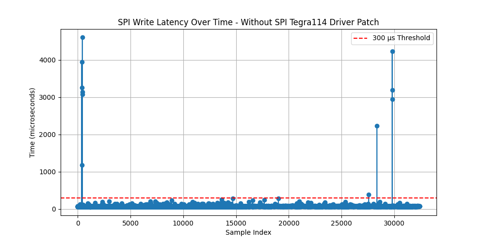

Before:
Avg: ~240 µs
Median: 240 µs
Stdev: ~51 µs
After
Avg: ~58 µs
Median: 56 µs
Stdev: ~31 µs
The patch seemed to result in better SPI performance and more consistent write times.

Results
  • The SPI write times observed when using the new patched kernel image, are in line with what was already mentioned in my previous post regarding Jetpack 5.1 (~60 µs per write instead of ~300 µs), jitter spikes still occur as shown in this figure:
Average: 68.91 µs, Median: 68.00 µs, Std Dev: 57.47 µs
