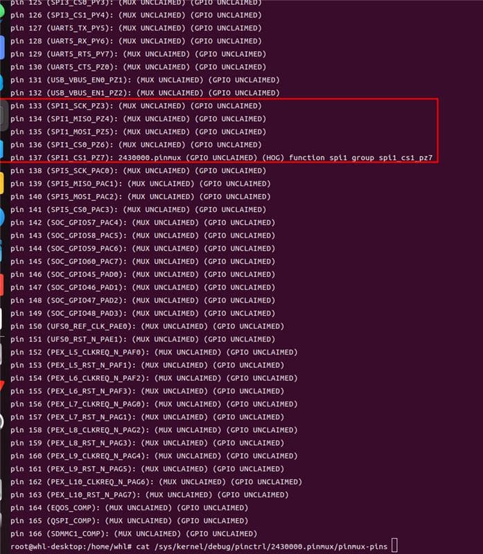

Also we have checked the pinmux and dtb ,here is it
using sudo cat /sys/kernel/debug/pinctrl/2430000.pinmux/pinconf-groups check

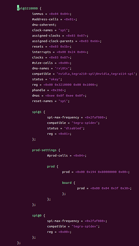

and what demg you want ,I just print the log in “tegra_spi_start_transfer_one“
and here is the dtb
dtb.txt (362.1 KB)

From the dmesg you shared, both SPI1(3210000.spi) and SPI3(3230000.spi) have been probed correctly.
[    9.224570] spi-tegra114 3210000.spi: Adding to iommu group 1
[    9.242914] spi-tegra114 3230000.spi: Adding to iommu group 1

I found something strange ,after I use the /opt/nvidia/jetson-io/jetson-io.py
to watch the cat /sys/kernel/debug/pinctrl/2430000.pinmux/pinmux-pins (for I can’t find this /sys/kernel/debug/tegra_pinctrl_reg point)
but I can’t get the spi function
Sorry, due to the forum’s restrictions on new users, I will still use the QOP account to communicate with you.
I dtc the device-tree found that the pinmux just modify the only one pin (SPI1_CS1_PZ7),so we can watch it on pinmux-pins.So I try to add the point on my overlay dtbo like this:

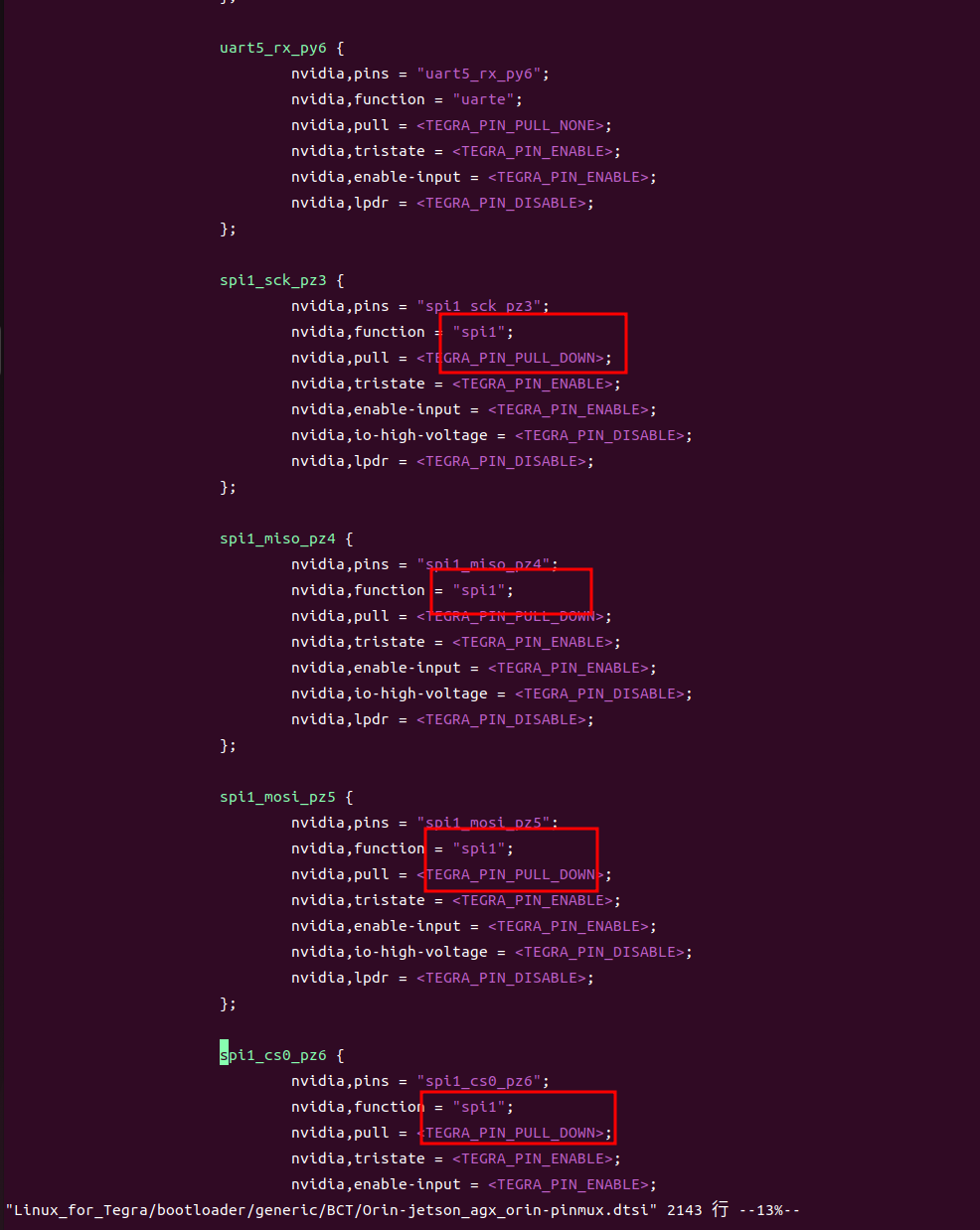

yes,I have flashed the clean JP6.2(r36.4.3) and use Jetson-IO to enable SPI function.And it can work.but we have custom design of 40pins header on the custom carrier board.I have a question about PINMUX config file
we use the file “Orin-jetson_agx_orin-pinmux.dtsi” to config the custom board ,and check a lot pinmux function result like uart ,gpio .They all worked ,but only the spi1 dont work.
if I dont config the spi in pinmux@2430000{ ,it will use the pinmux.conf ?

If it can work, you can add the similar configuration for your custom carrier board.
Pinmux dtsi is loaded in early boot stage(MB1) to configure the default pinmux.
The answer here is YES.
The configuration under pinmux@2430000 is loaded by pinctrl driver and it would be configured during kernel boot.
