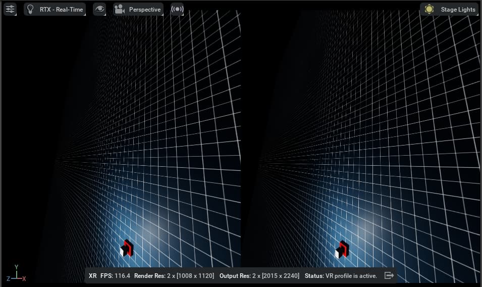

With Isaac Sim 4.2.0 I used the steamvr extension in my standalone script to stream the content to my VR headset (Index). I enabled the VR extension in my standalone script with: enable_extension(“omni.kit.xr.profile.vr”)
enable_extension(“omni.kit.xr.system.steamvr”)
and everything is working as expected. Now with the update to Isaac Sim 4.5 I’m using the exact same setup and the vr extension is not displaying any image on the vr headset. The streaming starts and there is no Error in the log but no image is displayed. Starting Isaac Sim 4.5 from the selector everything is working fine and I can see the stream in my vr headset.

I also tried to get the same thing working with openXR but the problem is exactly the same.
Could you please specify which documentation you followed when setting up the connection? Providing this information will help us better understand your process and assist you more effectively.
I have attached two simple test scripts for Isaac Sim 4.2 and 4.5 where the problem can be reproduced with. I also attached the Logs when running both scripts. What you can see from the images below is, that in Isaac Sim 4.2 the VR Stream is working as expected. In Isaac Sim 4.5 instead, the Screen stays black. When closing the VR Stream from the side panel, Isaac Sim 4.5 crashes immediately.
I hope that makes my problem more clear.
