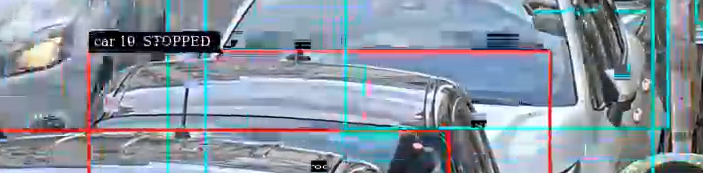

I’ve observed in deepstream pipeline when i have nvanalytics component and direction set, for objects that are not in moving, there is a “stopped” state. How can i extract this state in order to use it in my code also where is it stored?

it is in NvDsAnalyticsObjInfo’s objStatus. please refer to deepstream_nvdsanalytics_meta.cpp.
I didnt’t find anything about this state in deepstream_nvdsanalytics_meta.cpp> I would like to extract this metadata like i get roiStatus or dirStatus. It has to be stored somewhere from where i can access it. Maybe it’s an attribute fro user_meta_data in nvanalytics. Can you help with this information? because i have searched everywhere, including documentation and samples and I haven’t found anything about this. This “stopped” state doesn’t appear for all object that have not direction, appears after a certain time of not moving for an object.
please refer to parse_nvdsanalytics_meta_data in deepstream_nvdsanalytics_meta.cpp. this code is used to get NvDsAnalyticsObjInfo. “stopped” is stored in NvDsAnalyticsObjInfo’s objStatus.
NvDsAnalyticsObjInfo * user_meta_data = (NvDsAnalyticsObjInfo *)user_meta->user_meta_data;
I have done this, then i get the direction: if (user_meta_data->dirStatus.length()){
out_string << " object " << obj_meta->object_id <<
" is moving in " << user_meta_data->dirStatus;
}, but how can i get the stopped state?
