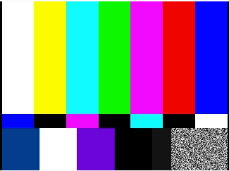

If I try to use the command:
`gst-launch-1.0 uridecodebin uri=rtsp://127.0.0.1:8554/test ! nvoverlaysink`
directly from JetsonNano I only get the following output:
![RTSP output](https://global.discourse-cdn.com/nvidia/original/3X/9/a/9a3cdd240254383021dadfc2d66031c5d21ea387.png)
Any idea what I could be missing?

We have deprecated omx plugins. Please try
```auto
./test-launch "v4l2src device=/dev/video1 io-mode=2 ! image/jpeg,width=1280,height=720,framerate=30/1 ! nvjpegdec ! video/x-raw ! nvvidconv ! nvv4l2h265enc ! rtph265pay name=pay0 pt=96"
Or try _nvv4l2decoder_ for MJPEG decoding:
```auto
./test-launch "v4l2src device=/dev/video1 io-mode=2 ! image/jpeg,width=1280,height=720,framerate=30/1 ! jpegparse ! nvv4l2decoder mjpeg=1 ! nvv4l2h265enc ! rtph265pay name=pay0 pt=96"

Both work! Fantastic!! I guess this one is solved, thank a lot!

Actually if I use this command I do get an extremely laggy image accompanied by by the following errors:
> WARNING: from element /GstPipeline:pipeline0/GstNvOverlaySink-nvoverlaysink:nvoverlaysink-nvoverlaysink0: A lot of buffers are being dropped.
> Additional debug info:
> gstbasesink.c(2902): gst\_base\_sink\_is\_too\_late (): /GstPipeline:pipeline0/GstNvOverlaySink-nvoverlaysink:nvoverlaysink-nvoverlaysink0:
> There may be a timestamping problem, or this computer is too slow.
On the other hand if a run:
> gst-launch-1.0 v4l2src device=/dev/video1 io-mode=2 ! image/jpeg,width=1280,height=720,framerate=30/1 ! nvjpegdec ! video/x-raw ! xvimagesink
It runs smoothly with negligible delay.
