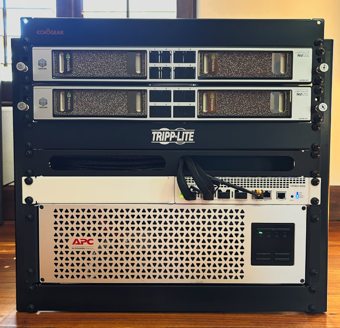

The model card for [lukealonso/MiniMax-M3-NVFP4](https://huggingface.co/lukealonso/MiniMax-M3-NVFP4) notes that a vLLM container for SM120 is forthcoming and that the model may be difficult to run “due to the specialized kernels required.” After spending time waiting for upstream instructions I worked out a working configuration for 4x DGX Spark (GB10, sm\_121) and wanted to share what worked so that other folks with DGX Spark clusters can serve the model without starting from scratch.
@eugr’s [spark-vllm-docker](https://github.com/eugr/spark-vllm-docker) was used for this process.
## Requirements
1. A custom container image. The model needs:
2. Multi-node launch must be `--no-ray` (PyTorch distributed), not Ray. With Ray the chthonic build does not initialize the MiniMax M3 parsers cleanly. The launcher is `launch-cluster.sh --no-ray --master-port 29501`.
3. The vLLM serve flags that worked for me on 4 nodes:
4. NCCL/RoCE environment. On DGX Spark with a CX7 fabric, the values that mattered were:
5. The `--no-ray` flag in step 2 is what makes the b12x runtime metadata check pass. If you skip it you get a startup error related to `B12XPagedAttentionScratchCaps. __init__ ` missing `copy_runtime_metadata`.

- Cold startup is long… roughly 10 minutes for shard loading plus several more minutes for profiling, KV cache allocation, B12X MSA warmup, and CUDA graph capture (FULL mode is the slowest to capture). Multimodal warmup adds another 2 to 3 minutes. Total cold start on the head node was about 15 to 18 minutes on my setup.
- Multimodal… send images as data URIs in `image_url.url` to avoid the model server fetching external URLs. Multimodal warmup completes successfully with `--skip-mm-profiling` on the chthonic build.
- Performance snapshot from my llama-benchy run ( [LLM - Spark Arena Benchmark](https://spark-arena.com/benchmark/sub1781926492932:) ):
  - Generation tokens/sec, mean plus or minus std, concurrency 1: roughly 9 to 10 t/s across depths
  - Concurrency 2: 14 to 18 t/s for depths up to 32768 (higher depths skipped because KV budget exceeded)
  - Concurrency 5: roughly 26 t/s at depth 0
  - Prompt processing (`pp2048`) ranges from about 5000 t/s at depth 0 down to about 600 t/s at depth 262144
