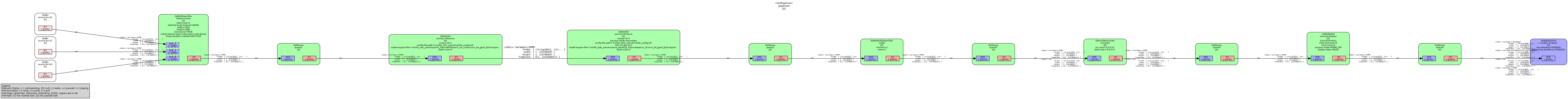

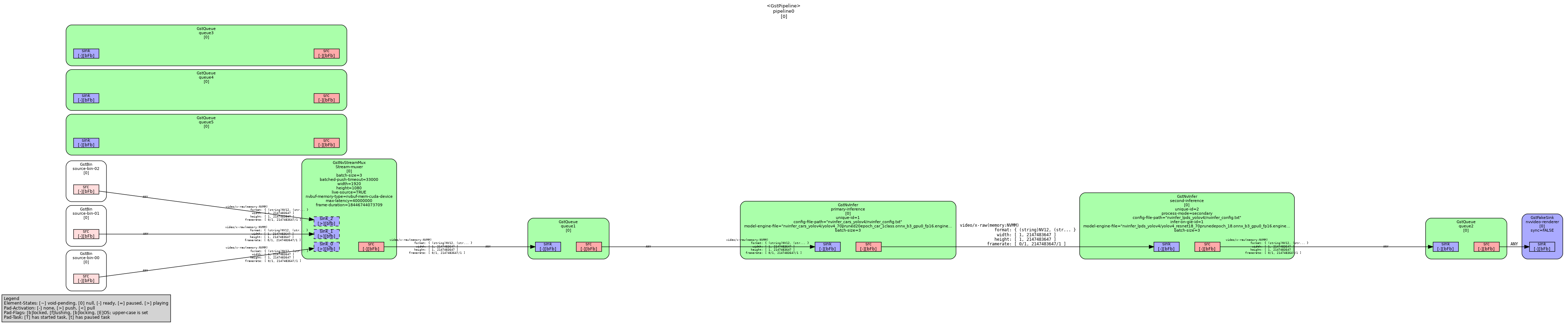

Can you tell us your complete pipeline and the parameters you set with the pipeline?
i sent a pipeline graph using gsrtreamer dot file
How did you send the dot file? I can’t get it
i convert it to png

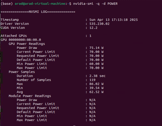

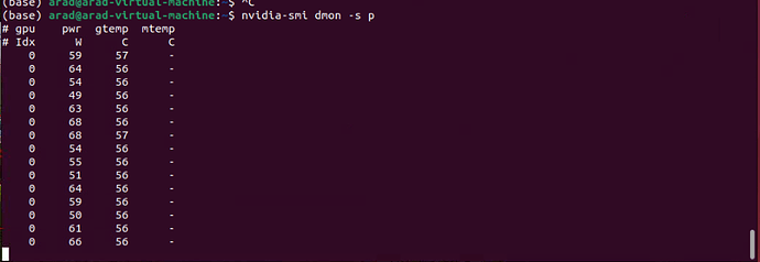

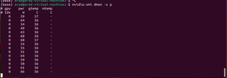

the GPU-Process is between 70 and 90
the vram is 1.07GI

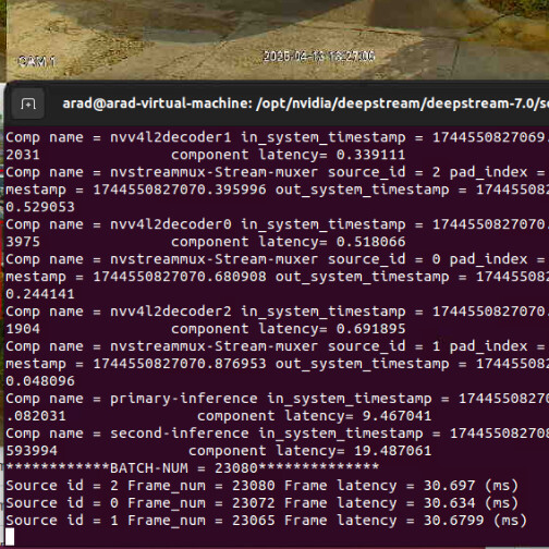

i change batch-size for secondary object to 16 and it works well for 3 video(30ms latency) but when i change number of source to 4 i get atleast 150ms(the gpu-process sometimes is 100% with only 1.07GI how can i fix this with vram and gpu-process tradeoff)
You need to know the maximum number of the cars you need to handle. The GPU compute power is limited. The GPU loading reach to 100% means the inferencing is overloaded. Either you try to find some faster LPD model or you need to switch to better GPU.
