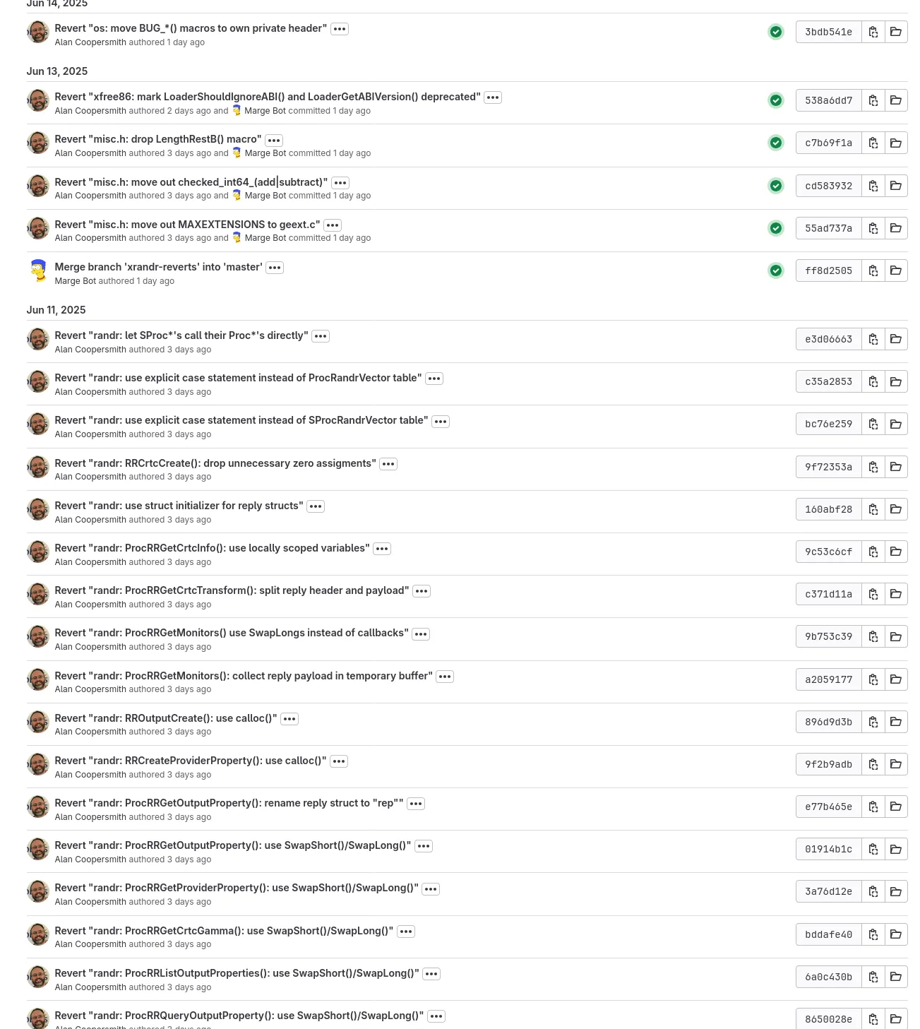

> **[The Latest X.Org Server Activity Are A Lot Of Code Reverts](https://www.phoronix.com/news/X.Org-Server-Lots-Of-Reverts)**
> The X.Org Server has been seeing a lot of commits this week..
dont think xlibre is gonna be the future

@gulafaran keep in mind that some of these reverts may have been politically or personally motivated (I’m not saying they were for sure, definitely not all of them, but it is a possibility that at least some were).
