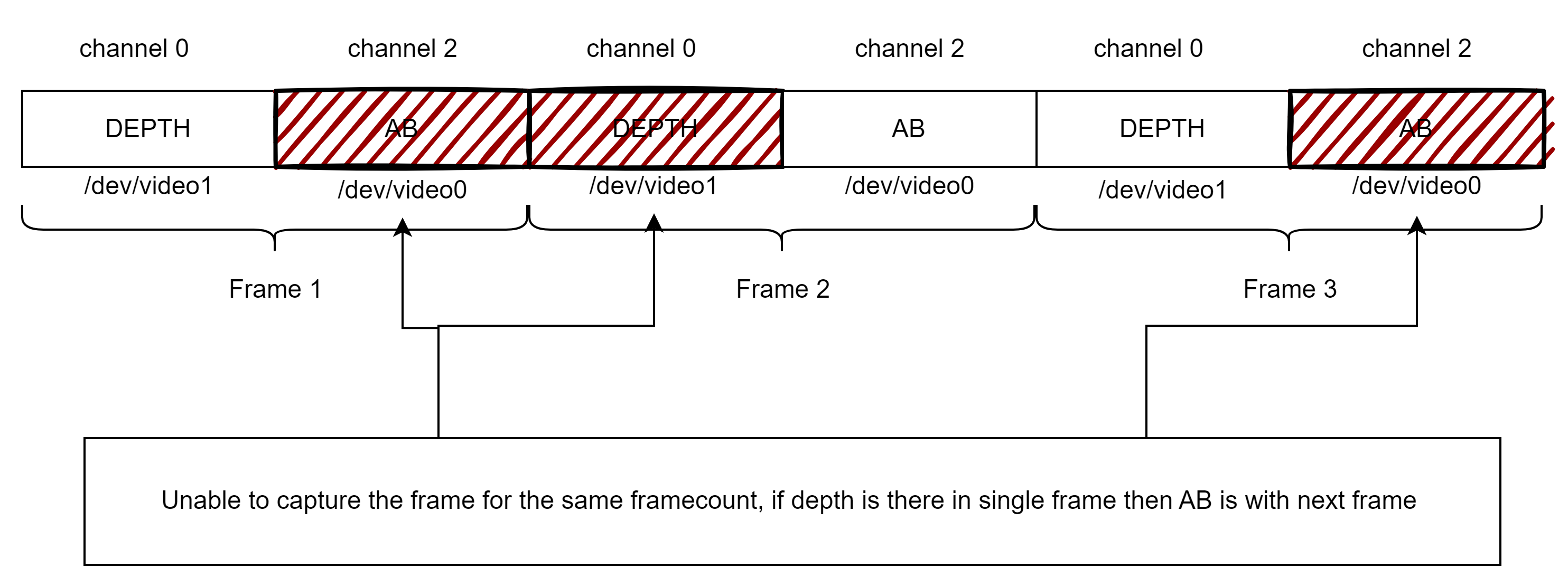

Hi @JerryChang
So, is it possible if I remove the dummy node from the dts and create only one subdev.
From single subdev link 2 video nodes to capture the 2 channel frames from the single request control?
Sensor is sending the two image data in each channel for each frame count. but at host side currently with this approach, we are receiving the data like below (as serial)
End result is like below diagram, because sensor send the 2 frames for one for each channel.
hello kishan.kava,
I don’t know, we’ve never verified this scenario.
you may see-also Constraints section for reference.
