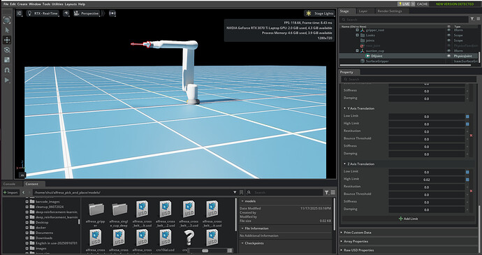

Surface Gripper does not work.
I created a surface gripper with following steps.
1. Load gripper alfresa\_single\_cup\_UR.
 ![Screenshot from 2025-11-18 12-27-34](https://global.discourse-cdn.com/nvidia/original/4X/6/4/e/64efa672313eb09390fdfd1bd45841ae21f1852d.jpeg)
2. Create a xfrom suction\_cup at gripper tcp.
 ![Screenshot from 2025-11-18 12-27-51](https://global.discourse-cdn.com/nvidia/original/4X/f/6/0/f605926c39bf23de93e12f8d67cc6fdd303726a3.jpeg)
1. Create a D6 joint under suction\_cup. Set body 0 as alfresa\_single\_cup\_UR. Other settings as follow.
 ![Screenshot from 2025-11-18 12-29-54](https://global.discourse-cdn.com/nvidia/original/4X/0/6/b/06b7f6ef10550a348e8865e813734ad89d31e335.jpeg)
 ![Screenshot from 2025-11-18 12-30-10](https://global.discourse-cdn.com/nvidia/original/4X/9/b/c/9bcb79f4d87a92a398ee336ab7b2bd229d6d0ba3.jpeg)
1. Create a Surface Gripper node. Set Attachment point as the D6 joint created in step 3.
 ![Screenshot from 2025-11-18 12-31-09](https://global.discourse-cdn.com/nvidia/original/4X/7/e/a/7ea3455988472e472a06d34f4fb6fa1525811614.jpeg)

Finally solved the problem without knowing why.
I created a small cyllinder on tip of the gripper, then set it as the body 0 of D6 joint, then it works.
