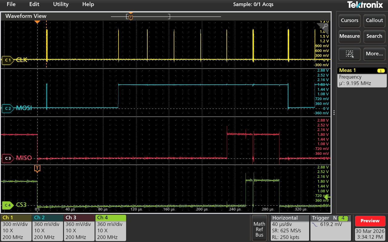

Hi Nvidia,
I used the Jetpack 7.1 R38.4 SDK on our custom-designed carrier board.
The SPI3 connected to the NPCT760AAEYX TPM chip and the driver probed the failure.
[10.366133] tpm_tis_spi: Probe of SPI3.0 failed with error -110.

The figure below shows the oscilloscope waveform from the measurement.
I don’t know why the SPI3 clock isn’t generating a signal.
Do you have any suggestions on how I should go about debugging this?

Hi Kevin,
I tried shorting the MOSI and MISO pins on SPI3 to test them.
The signal waveform at power-on is shown below; at this point, the system has not yet booted up.
After booting into Ubuntu, I ran the spidev_test command.
But the receiver did not receive any data.
We would suggest verifying with SPI loopback test before connecting the SPI device like TPM.
Could you share the full dmesg and device tree in this case for further check?

Hi Kevin,
Yes, when testing the SPI loopback, can see changes in the MISO, MOSI, and clock waveforms on the oscilloscope?
Do you mean SPI3_CLK output the expected waveform when you run SPI loopback test?
If so, SPI function of Thor has been working correctly.

Hi Kevin,
Let’s first clarify some hardware signal issues.
When performing an SPI loopback test, will there be any changes in the MISO, MOSI, and CLK waveforms on the oscilloscope?
I ran an SPI loopback test and saw the transmitted and received data in the terminal, but I didn’t see any changes in the MISO, MOSI, and CLK waveforms on the oscilloscope.
It is not the expected result to me.
As you can receive the expected data, there should be the waveform on MOSI line.
Have you confirmed that you measure the correct pin?

I only use an LA analyzer to measure the SPI3 connection between the TPM with the chip manufacturer.
Coldboot:
Rebind: Execute : echo spi2.0 > /sys/bus/spi/drivers/tpm_tis_spi/bind
