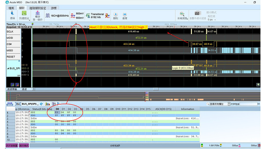

Even after making the above changes, the host is still unable to communicate properly with the TPM.
Could you please advise me on how to configure the SPI-related functions? Based on the results from the manufacturer’s LA analyzer, it appears that the host pulled the CS pin high too early, causing the communication to fail.
CS pin went high too early in comparison to what, exactly?
Hi Chris,
Please reference as follow pictures:
Coldboot:
Rebind: Execute : echo spi2.0 > /sys/bus/spi/drivers/tpm_tis_spi/bind
It went high too early in comparison to the Data Read phase. The CS pin went high immediately after receiving the READY signal (MISO = 0x01), without waiting for the host to actually clock out and read the data.

ch0 is clk, ch1 is cs, ch2 is mosi, and ch3 is miso. After CS is pulled to low and MOSI outputs 83d40f00, wait 845.8 μs, then pull MISO high, and wait another 293.84 μs.
Could it be that after receiving data from MISO 01, the clock signal wasn’t sent, causing the TPM to stop transmitting subsequent data?
According to the TPM specification, once the CS is pulled high, the current transaction is immediately terminated, resulting in the subsequent data not being read at all.
From the waveform you shared, both CS and SPI-CLK output the expected signal.
Could you also check with your vendor for this issue? as I believe SPI is working as expected.

Yes, I have already confirmed the waveforms of these analyzers with the TPM vendor, and the waveforms from the LA analyzer do not appear to comply with the TCG TPM SPI specification.
[Header] → [Wait States (00…01)] → [Data]
The SPI communication with the TPM 2.0 chip fails during the transition from the Flow Control (Wait State) Phase to the Data Phase.
Although the TPM correctly asserts the “Ready Bit” (0x01) on the MISO line, the SPI controller de-asserts the Chip Select (CS) signal immediately after the flow control message is completed.
Due to a software processing delay between the two spi_sync() calls, the CS remains High for a duration that causes the TPM internal state machine to reset/abort the transaction. Consequently, no data is returned during the subsequent Data Phase (MISO remains 0xFF or High-Z).

Hi pomelo_hsieh,
Good to hear that the patch helps for your case.
Could you also share the full dmesg for reference?
Hi Kevin,
Would you like to see the dmesg output with the spi_tegra114_debug_cs flag enabled, or is the standard dmesg output sufficient?
Yes, we would like to check the log with debug flag enabled.
