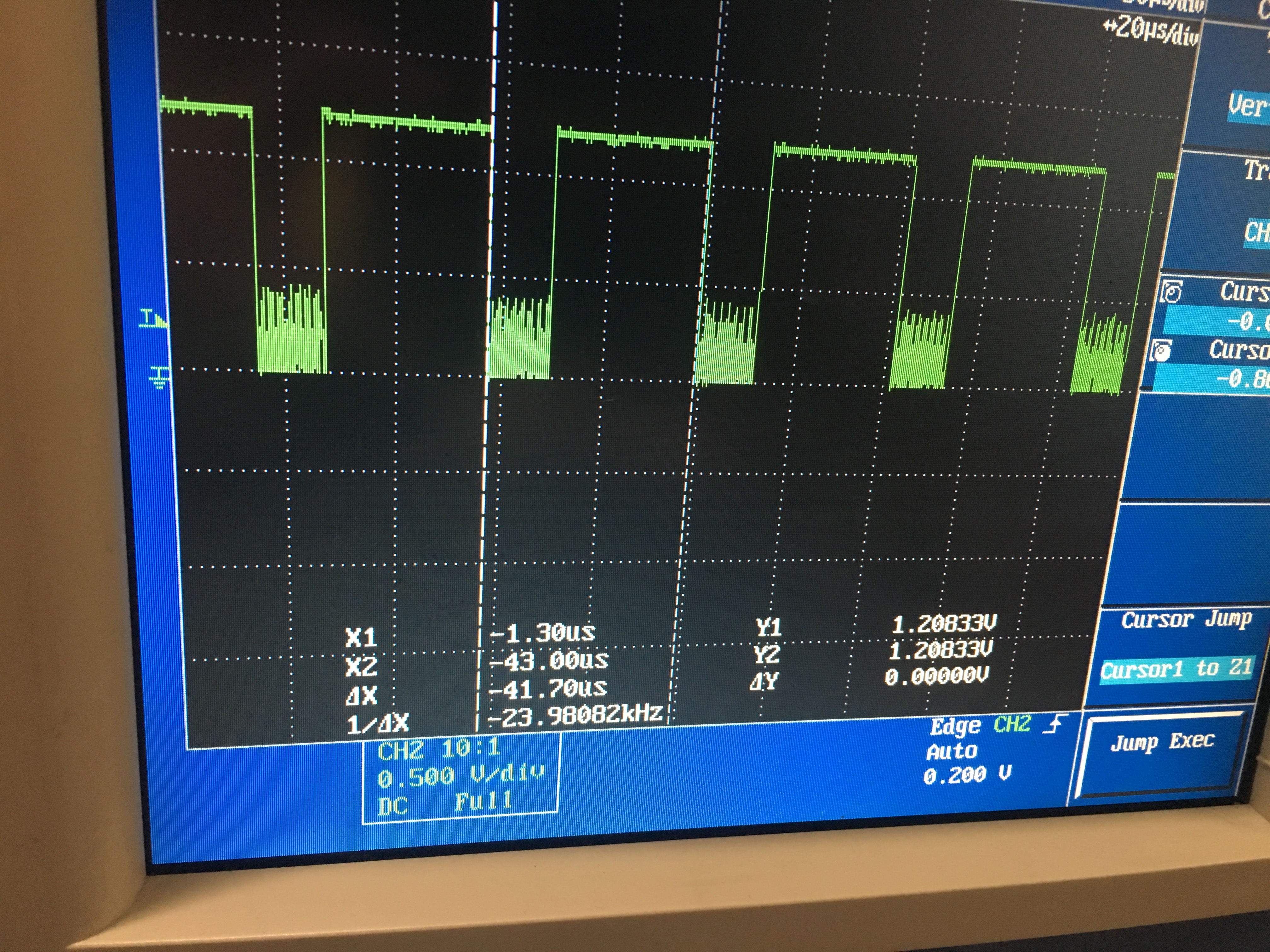

We have completed our hardware test. It seems the signal output of TC358746 CSI Tx mode is ok based on our test.
We have contacted local technical support of Toshiba for TC358746 MIPI CSI shipset. They provided a Excel datasheet
which allows us to input some basic parameters of camera and generated some values used for TC358746 registers.
We put those valuses into the registers and can read them back. So, these parameters for TC358746 seems ok.
We built up our driver based on the source code from OV5693, we made some modification.
Please see attached tc358746 driver source code.
But it is not working and we cannot capture video from our camera.
Please see attached V4L2 error report for error from V4L2 driver. We used the following command line:
v4l2-ctl -d /dev/video0 -w --verbose --set-fmt-video=width=1077,height=788,pixelformat=RGGB --set-ctrl bypass_mode=0 --stream-mmap --stream-count=1 --stream-to=test.
Please see attached nvgstcapture-1.0error1 and nvgstcapture-1.0error2 for errors found under nvgstcapture-1.0 command.

We capture the clk and data lane signal by scope.
TLPX =64ns THS = 64ns THS-ZERO = 200ns CSI-CLK=187.5MHz

How do I set " pix_clk_hz"? Our sensor output clk is 33.75Mhz.That’s why I set " pix_clk_hz" as this value. And how do I set CSI-CLK frequency?
Does it means tx1 csi channel does not receive any MIPI package according to attachment Vn-Vp.jpg?
Base on TOCHIBA engineer discussion,TX1 MIPI lane does not set any terminal resistance.How set TX1 MIPI compatible TC358746 timing?

Does the sensor output as continuous mode? Could you try discontinuous mode.
