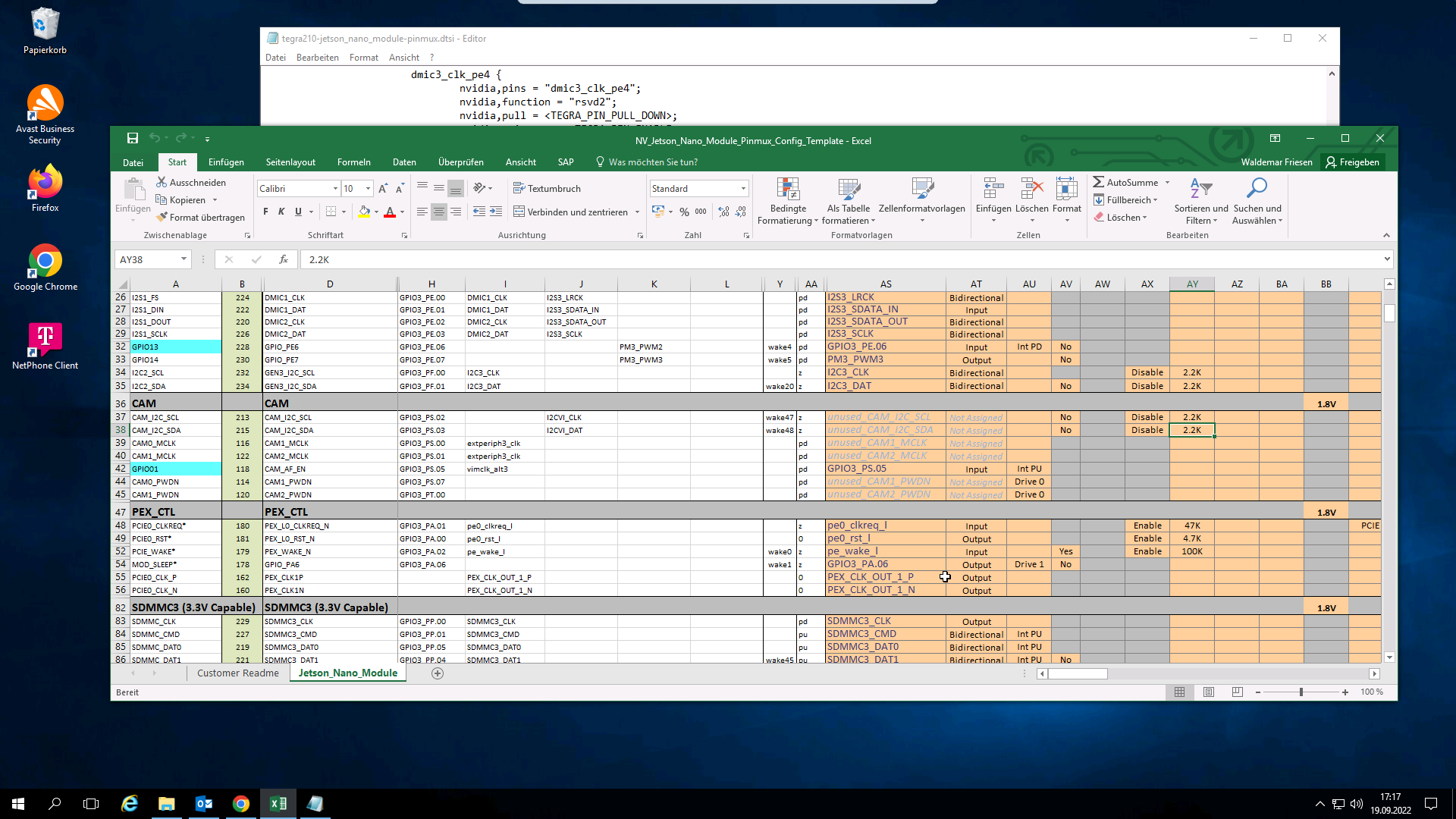

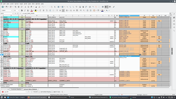

could I get the pinmux spreadsheet file with correct setting for above camera interface from you?
ff81c759cf49891a6957b828e6b1f0564a319260_2_425x499
I have tried to change the pin but the setting is gray outed - is it okay?
could it be possible with that setting to get working camera, despite greyed out ?
hello waldemar.friesen,
the difference (B01 and A02) is newer version of carrier board to have addition camera slot.
may I know why you’re toggle the pin settings of CAM1_PWDN and CAM2_PWDN?
you should check reference driver, these two were used by camera driver as reset-gpio,
for example,
#define CAM1_PWDN TEGRA_GPIO(S, 7)
#define CAM2_PWDN TEGRA_GPIO(T, 0)
