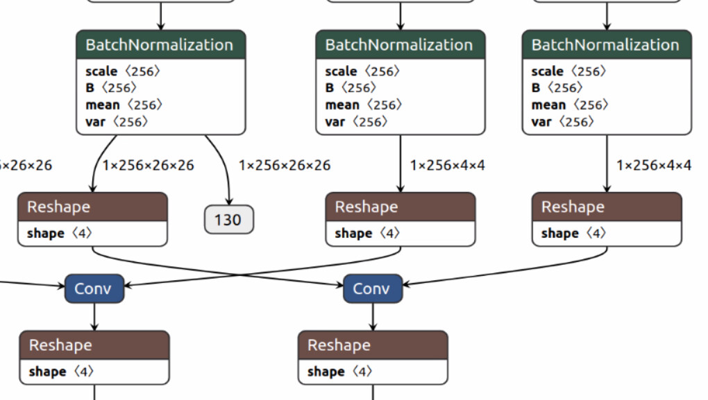

when i convertsiamfcpp to tensorRT engine, I got this bug.
conv_24 is that blue node on the right,it use this right input as its filter,but it seems not works, has this happened to anyone?

It looks like conv does not support the input of two tensors. The kernel weight must be fixed otherwise the error will be reported.How should this situation be handled?
Hi @lee_gaojun,
TRT only support conv weights from ONNX initializer, we recommend you to change the model, do not use conv weights from dynamic input tensor.
