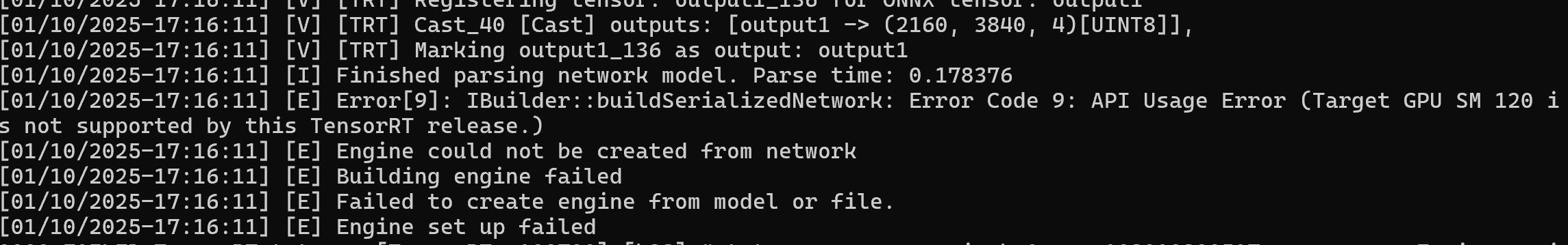

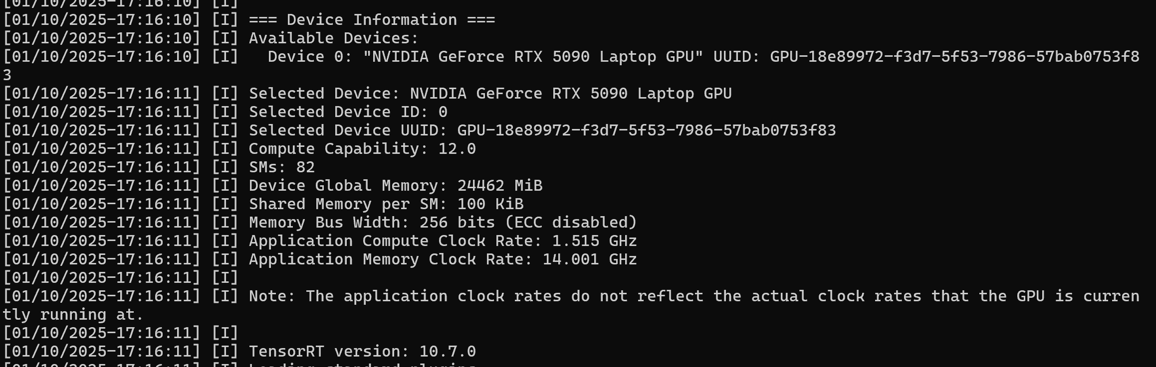

Description
TensorRT 10.7 doesn’t support for NVIDIA 50series
Environment
TensorRT Version: 10.7
GPU Type: Nvidia 5090 laptop
Hi @user71072 ,
    • TensorRT 10.8 and later versions confirm support for NVIDIA’s Blackwell GPUs, which includes the 50-series features. This enhancement is expected to improve compatibility with these new GPUs.
