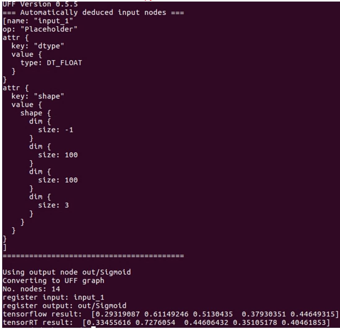

It is still not working, here is the code we are using for testing.
from future import print_function
import numpy as np
import tensorflow as tf
import tensorrt as trt
import uff
import pycuda.driver as cuda
import pycuda.autoinit
def volume(x):
vol = 1
for i in x:
vol *= i
return vol
---- define network
with tf.Graph().as_default():
input = tf.placeholder(tf.float32, [None, 100, 100, 3], name=‘input_1’)
x = tf.layers.Conv2D(10, 2, strides=1, padding=‘same’, name=‘conv1’)(input)
x = tf.layers.MaxPooling2D(2, 2, padding=‘valid’, name=‘pool1’)(x)
#x = tf.layers.Flatten()(x)
vol = volume(x.shape[1:])
x = tf.reshape(x, shape=(-1, vol))
net = tf.layers.Dense(5, activation=tf.nn.sigmoid, name=‘out’)(x)
init = tf.global_variables_initializer()
sess = tf.Session()
sess.run(init)
output_names = [net.op.name]
graphdef = tf.get_default_graph().as_graph_def()
frozen_graph = tf.graph_util.convert_variables_to_constants(sess, graphdef, output_names)
frozen_graph = tf.graph_util.remove_training_nodes(frozen_graph)
# ---- save to pb
# tf.io.write_graph(frozen_graph, './', 'toy.pb', as_text=False)
---- model to uff
uff_model = uff.from_tensorflow(frozen_graph, output_names)
G_LOGGER = trt.Logger(trt.Logger.Severity.ERROR)
with trt.Builder(G_LOGGER) as builder, builder.create_network() as network, trt.UffParser() as parser:
builder.max_batch_size = 1
builder.max_workspace_size = 1 ** 30
parser.register_input(“input_1”, (3, 100, 100), trt.UffInputOrder.NHWC)
print(‘register input:’, input.op.name)
for name in output_names:
print(‘register output:’, name)
parser.register_output(name)
parser.parse_buffer(uff_model, network)
engine = builder.build_cuda_engine(network)
---- random input and save to bin/npy
np.random.seed(100)
temp = np.random.rand(1, 100, 100, 3).astype(np.float32)
---- tensorflow inference
tf_results = sess.run(net, feed_dict={input: temp})
---- tensorRT inference
h_input = cuda.pagelocked_empty(trt.volume(engine.get_binding_shape(0)), dtype=trt.nptype(trt.float32))
h_output = cuda.pagelocked_empty(trt.volume(engine.get_binding_shape(1)), dtype=trt.nptype(trt.float32))
d_input = cuda.mem_alloc(h_input.nbytes)
d_output = cuda.mem_alloc(h_output.nbytes)
context = engine.create_execution_context()
bindings = [int(d_input), int(d_output)]
stream = cuda.Stream()
cuda.memcpy_htod_async(d_input, temp, stream)
context.execute_async(1, bindings, stream.handle, None)
cuda.memcpy_dtoh_async(h_output, d_output, stream)
stream.synchronize()
---- let’s see
print("tensorflow result: ", tf_results[0])
print("tensorRT result: ", h_output)
engineering has made a fix “Fixes Flatten op in UFF so that it transposes when necessary”, and is scheduled for the next TRT release.
