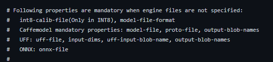

since i already convert my etlt file to engine file, my config file is set like this
can anyone provide me some hint about how to demo my model with this github?(maybe with another apps like test1 or something?) or how to solve the error. Thanks

please check the model path configured in pgie config, is there the model as you configured.
i did put my engine file and python file in the same folder, is that what you mean? Or did i need to change
this path to “model-engine-file=./model_isbi.engine”?
can you try to change the “batch-size=1” to “batch-size=3” in dstest_segmentation_config_industrial.txt
I’d asked for some help in our country’s nvidia branch office, they said the problem occurred when of the wrong parameter was set when converting the model. But when we changed to the right parameter, tx2’s memory isn’t enough, so i’m currently working on it. Thank you for your help, this problem is currently solved.
