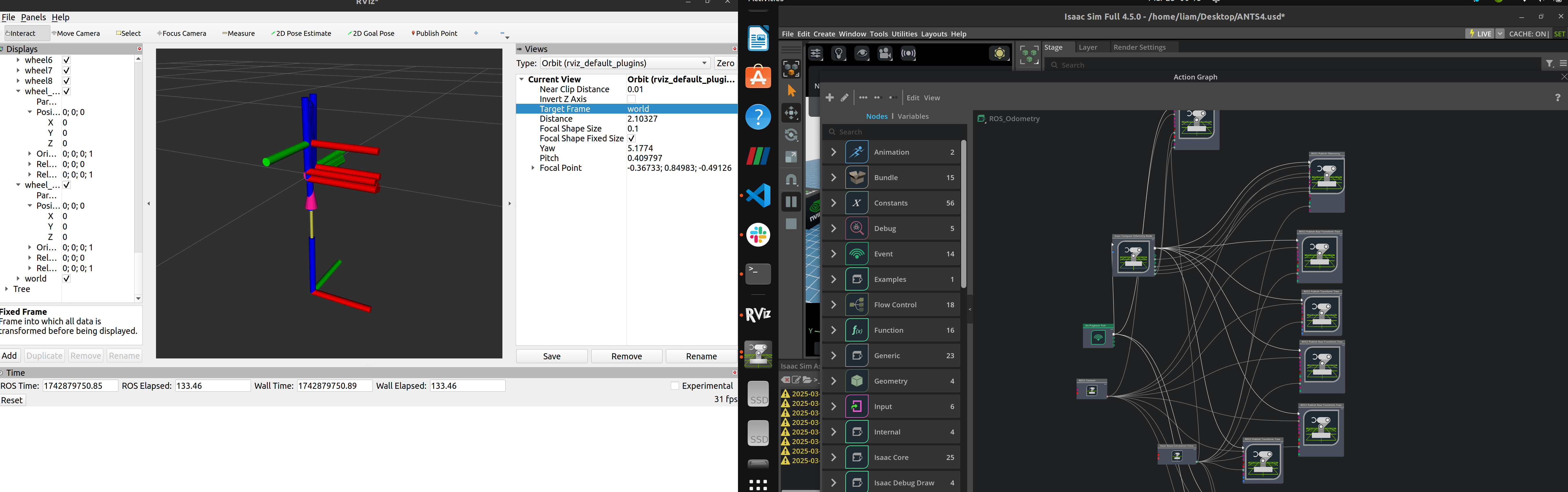

Detailed Description

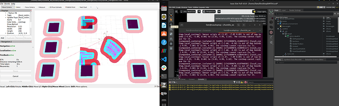

I have been building an autonomous rover simulation and recently saved a flattened version of the original file after reorganizing some prim meshes under new xforms. Although the xforms are placed correctly, the TF tree appears to reference the meshes within those xforms rather than their new positions. As a result, when I visualize the simulation in RViz2, all the meshes seem to be constrained to the center of the world. This misalignment causes the costmap to stop updating once the robot moves far enough away, as the sensor is effectively “fixed” at the world center.
Steps to Reproduce
  1. Flatten the original file and move several prim meshes under new xforms.
  2. Launch the simulation and visualize the TF tree in RViz2.
  3. Observe that the TF tree reports the meshes as if they are centered, despite the xforms being correctly placed.
  4. Notice that as the robot moves, the costmap stops updating when the sensor appears to be out of range, since it remains fixed near the world center.
Error Messages
There are no direct error messages; however, the TF tree and RViz2 visualization clearly indicate that the transforms are not being updated as expected. Additionally, the costmap stops updating when the sensor (which should move with the robot) appears to be fixed.
(Please see the attached screenshots for my current TF tree and a demonstration of the issue during simulation.)

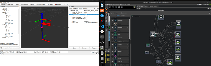

to add more clarity
I’ve been following the ros2 navigation example ROS2 Navigation — Isaac Sim Documentation
while building ontop of it for my use case. To provide as much detail as possible i have attached what im currently working with if its being difficult to recreate.
here is a video i recorded to show what is happening. The sim_lidar link is the only link that moves (parent base_link) and the rest seemed to be constrained to the center. and the wheel links spin irregularly at the center which im not sure why either.
https://youtu.be/Zo1TbL1j4eo
I did try to take out the world, map, and other probably not needed parents in the tree and similar things occurred still
Thank you for your time

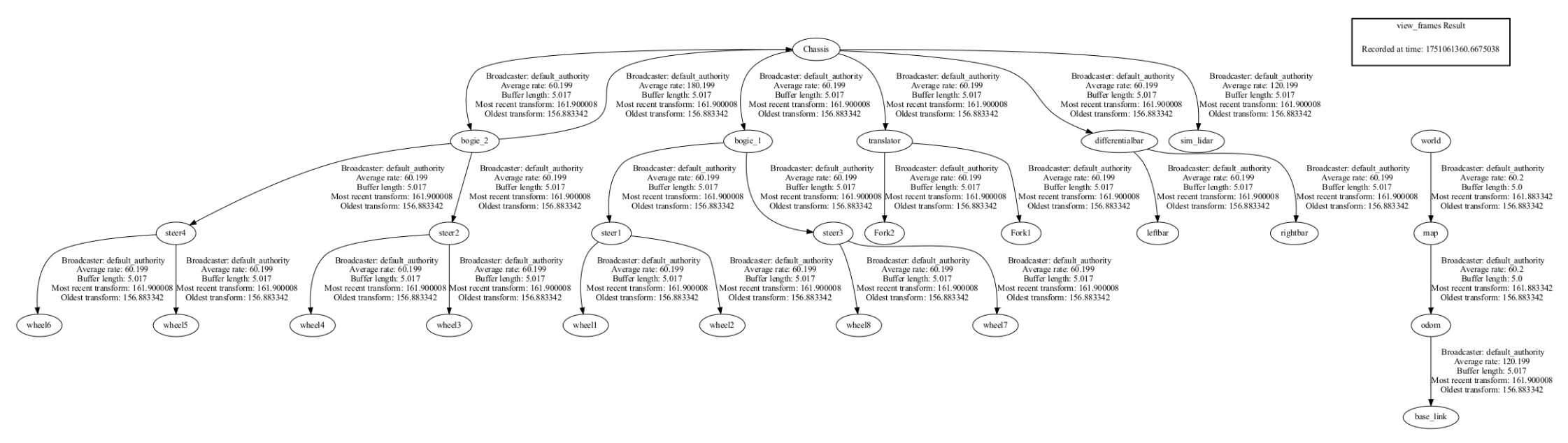

Hi @liam.murray sorry to get back to you late and thanks for your file.
I tried your example and something is wrong with your TF tree. You should only have one connected TF tree. But in your example, you TF trees are separated. You need to have the TF base_linkChassis
You can create an action graph to publish this TF. Please refer to our carter_navigation example for details (windows → examples → robotics examples → ROS2 → navigation → carter)
