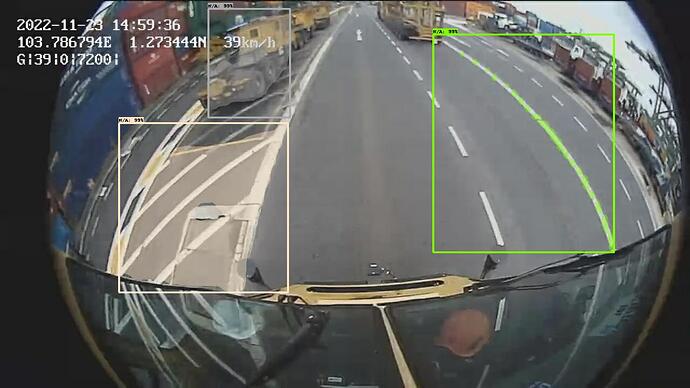

I’m training with attached config file.
Altogether 22 classes, so added background so total 23 classes in training.
The instance label file is as shown in below.
instance_label_singpilot.txt (406 Bytes)
single_broken_white_line is the dash line as shown in the following image.
That was in the training.
But in inference, it was never detected. What could be wrong?

In your shared image, I find several single_broken_white lines, for example, do you mean below can not be detected?
edit_or
January 17, 2023, 2:46am
#9
The green box is detection for solid line.
Our mask labelling for dash line is like below in red.
All images with those dash lines have no detection at all.
Is it because of mask config? Which one should I change?

Morganh
January 17, 2023, 2:48am
#10
Got it. Could you set a lower threshold and retry?
See MaskRCNN — TAO Toolkit 4.0 documentation
-t, --threshold
: The threshold for drawing a bbox (default: 0.6)
edit_or
January 17, 2023, 2:50am
#11
This is the command used. threshold is 0.5
mask_rcnn inference -i /workspace/Nyan/cv_samples_v1.3.0/mask_rcnn/data/FishEyes_Training/val -o /workspace/Nyan/cv_samples_v1.3.0/mask_rcnn/maskrcnn_annotated_images -e /workspace/Nyan/cv_samples_v1.3.0/mask_rcnn/specs/maskrcnn_train_resnet50.txt -m /workspace/Nyan/cv_samples_v1.3.0/mask_rcnn/experiment_dir_unpruned/model.step-165000.tlt -l /workspace/Nyan/cv_samples_v1.3.0/mask_rcnn/specs/instance_label_singpilot.txt -t 0.5 -k nvidia_tlt --include_mask --gpu_index 2

Tested with threshold 0.3.
Still not detected.
Morganh
January 17, 2023, 2:57am
#15
The -l is the directory of predicted labels in COCO format. It is a json file. Could you double check?
edit_or
January 17, 2023, 2:59am
#16
That could be the reason for N/A class for those detected classes. But no detection means I am referring to no bounding box.
For training, i have json file.
Morganh
January 17, 2023, 3:08am
#19
OK, please change the “-i” argument to use some of the training images.
We just want to narrow down to check if it works via some training images.
edit_or
January 17, 2023, 3:12am
#20
Training image also not detected. Is it mask configuration? But mask size for dash line is similar to solid line.
