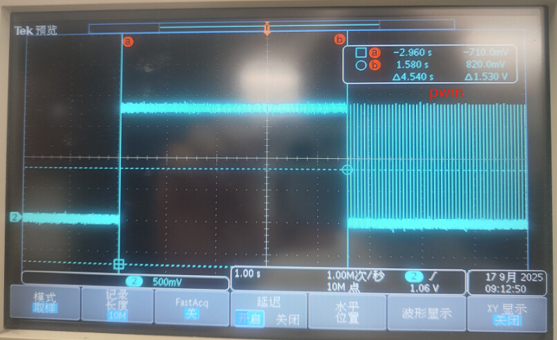

When using the TSC function to output PWM signals, we occasionally find that after setting the PWM frequency, we need to wait for a few seconds before the PWM signal is output. This issue occurs with a low probability, but once it occurs, it persists and requires a restart to return to normal.
When the issue occurs, we captured the following signals:

Is the delay about 4.5s as shown in your image?
Please share the steps how did you reproduce this on the devkit.
Is there the similar delay if you just simply enable a PWM output?
We are using Jetpack 6.2. The delay is 4.5 seconds as shown in my picture. Without restarting the device, this delay persists and remains around 4.5 seconds. The system can return to normal after a restart, but the delay does not occur every time. When the issue arises again, the delay may range from a few seconds to dozens of seconds.
It occurs occasionally, and we have not found a pattern to reproduce it.
We have found that if we first power on the platform and let the camera stream data for a period of time (ranging from several hours to more than ten hours) before enabling the TSC to generate PWM signals, the probability of delay occurrence becomes higher. Once the delay occurs, it will persist.
But it does not occur every time after the device is powered on.
