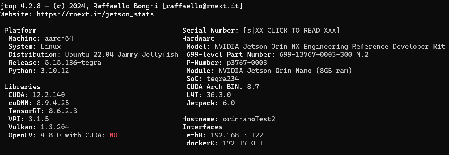

**• NVIDIA Jetson Orin NX Engineering Reference Developer Kit **
**• DeepStream 7.0 **
**• JetPack 6.0 [L4T 36.3.0] **
**• TensorRT 8.6.2.3 **

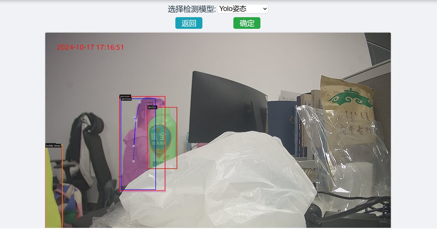

My source is a CSI camera. Now I am doing real-time inference calculations on image frames, using “tee+queue" for multi-way branching. In each branch, I use the inference model “nvinfer”(pgie) and then use “nvdsosd/nvsegvisual” to draw on the frame, and push them to the MJPEG stream for browser switching display.
Below is my pipeline diagram:

The problem I encountered is: I found it in the output image. For example, in the output yolo-pose inference result stream, I found yolo-od/yolo-seg/yolo-face and other results drawn together in the yolo-pose stream. Similarly, in the yolo-seg image stream that should show the actual segmentation drawing results, the inference result drawing of yolo-pose/yolo-od/yolo-face appeared, and so on.
1.The following figure shows the mjpeg stream of the yolo target detection, but the result of instance segmentation appears in the picture
2.The following figure shows the mjpeg stream of yolo-pose, but the result of yolo-instance segmentation appears in the picture.
