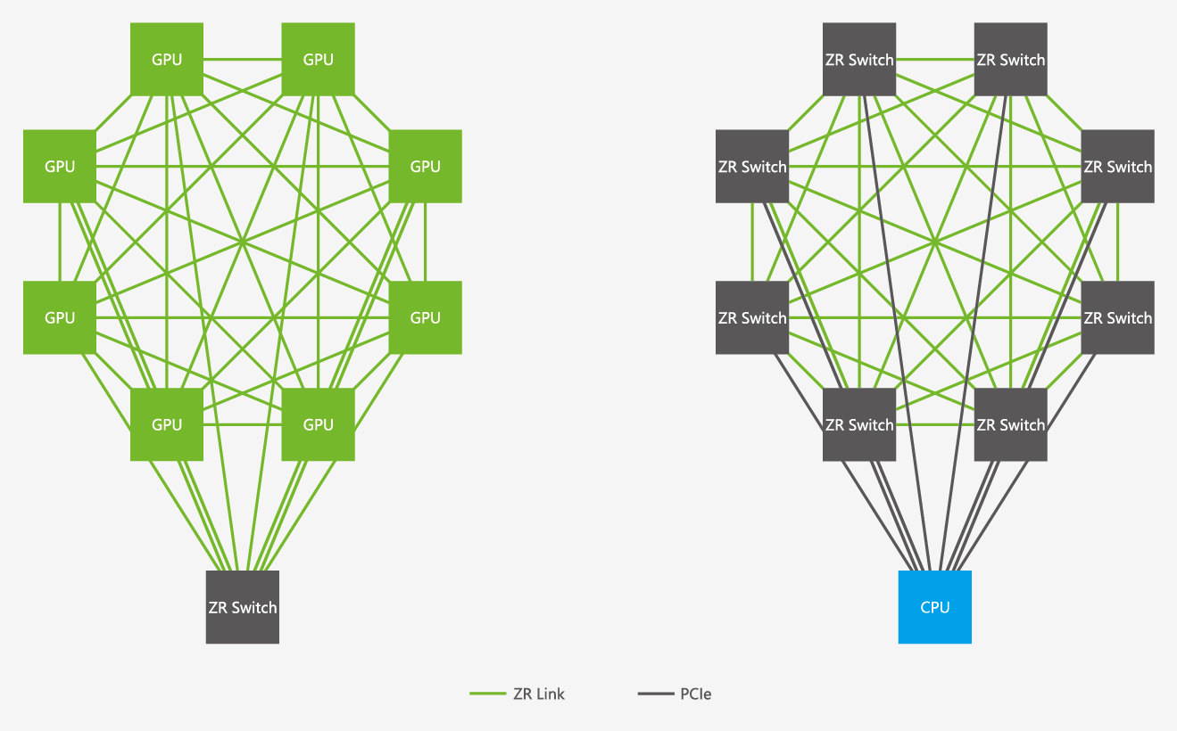

GPU core architecture diagram: The core code is Creeper 200, a new interconnection method, and L1.5 Cache is introduced between SM and L2 Cache to play a buffering role. Now, ZRLink can directly access L2 Cache, and each GPM has 8 ZRLinks for high-speed interconnection with GPM. And has a redundant design, even if one ZRLink link is damaged, causing direct communication between two GPMs in a full connection, the ZRLink link can pass through other GPMs to reach the GPM that needs to be accessed.
The interconnection method of 8 GPU modules: Among the 8 GPU Modules, each GPM is fully connected to each other, and each GPM will have a link connected to the Switch, forming a Fully connected + Star interconnection method. When exchanging data between two GPUs, the data exchange will be preferentially carried out through the full connection, and when accessing another GPU, they will be connected through the switch. At the same time, the interconnection topology between switches is also a Fully connected + Star interconnection method. When data exchange is performed between each switch (GPU), a fully connected link will be preferentially selected to ensure lower latency and greater bandwidth. In a system with 8 GPUs, the CPU can be directly connected to each switch to form a Star interconnection method to reduce latency without changing the existing CPU as much as possible.
This is a GPU consisting of 8 GPMs as shown in the figure. The middle DIE contains Switch and PCIe Host interfaces, which can take care of the high-speed interconnections between each GPM and other GPUs, while providing PCIe Host interfaces for each GPM to ensure it can be used in ordinary computers and improve versatility.
