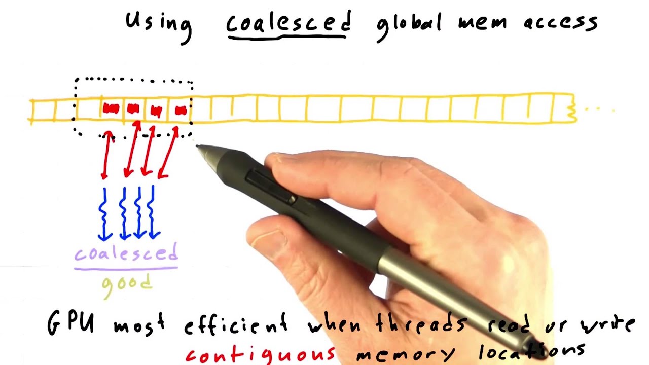

The situation arises when groups of multiple threads within a warp are reading aligned coalesced memory, but each of the groups of threads are reading from different locations.
One example is with 8-threads in a group, but it also occurs with 16-threads grouped together…
thread   read/thread   memory addr
0-7      8-bytes       addr_a
8-15     8-bytes       addr_b
16-24    8-bytes       addr_c
25-31    8-bytes       addr_d
addr_x is 64-byte aligned, and each time around the kernel inner loop we progress forward through each of the addresses. So in this example each group of 8 threads is reading 64-bytes coalesced
The problem arises specifically when there are 8-blocks running in parallel on each SM. I can also create this when reading 4-bytes per thread, but with 16-blocks running in parallel on each SM.
