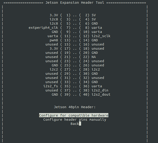

I2S2 is configured through the 40-pin header
PinMux verification output:
evk@tegra-ubuntu:~$ sudo /opt/nvidia/jetson-io/config-by-function.py -l enabled | grep i2s2
   2. i2s2 (12,35,38,40)

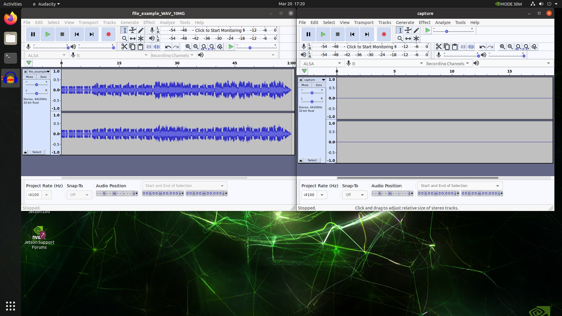

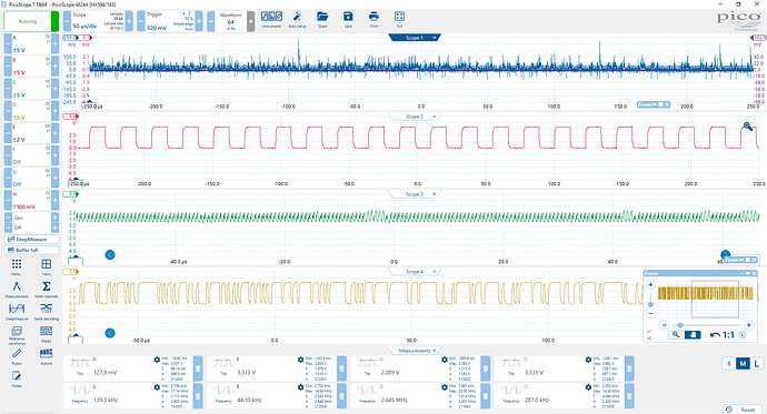

The codec card is detected, but I’m not able to hear any audio output. (only noise) I have followed the forums and implemented the device tree changes. TLV320AIC3204 Driver will support for AGX Orin 64GB SOM?
Could you help identify what might be missing in the setup?

This is not correct as TLV codec is connected to I2S2 on 40 pin header as per your info provided.
Please use below connection along with codec related mixer controls
amixer -c APE cset name=“I2S2 Mux” “ADMAIF2”
amixer -c APE cset name=“ADMAIF2 Mux” “I2S2”
TLV codec related mixer controls like speaker unmute, volume path setting etc…
aplay -D hw:APE,1 ~/Downloads/file_example_WAV_10MG.wav
Am not sure why you have used “I2S1 Loopback” “on” , Loopback is required only for I2S level internal loopback testing. IF you plan to test TLV speaker you should not set this.
I previously ran this setup with I2S2, and here is the complete configuration.
After applying these settings, I can hear the noise but not the actual sound.

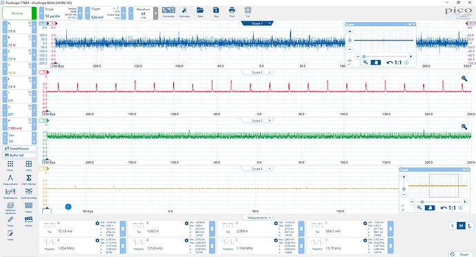

The I2S2 lanes were disconnected from the Codec and connected to the oscilloscope. here is the output
Hi Parashuram,
The clock summary values looks fine for I2S2 as per log. But the oscilloscope data seems not proper for some reason. Not aligning with the rate shown in the log file values.
Also, am curious to know how you connected MCLK to codec as on Orin AGX Aud_MCLK goes only to the internal RT5640 codec. Can you provide the pin details you connected to codec

As you suggested, I tried and checked the capture.wav file, but it contains no data, meaning nothing was recorded. I also probed the signals, and the results are as follows:

As I2S FS and SCLK is seen on scope, it is strange DOUT is not coming out for probe. I want to ignore the codec factor here.
Can you revert the TLV Codec related DT changes(roll back to original DT) and check the I2S2 DOUT signal with below command after I2S2 pinmux config with jetson IO.

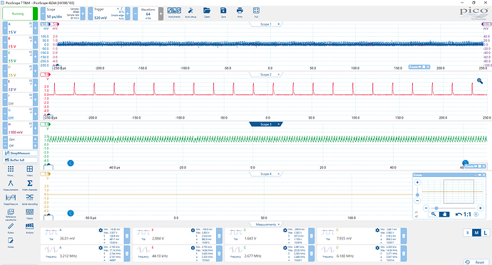

I have reverted to the original DT, and there is no TLV320AIC3204 codec DT present.
The probed signals are shown (details below). I observed some transactions on the DOut pin.
Regards,
Parashuram
Hi Parashuram,
Good to know the DOUT is having signal out. This confirms the I2S2 Pinmux and clocks are coming out of Tegra properly. We need to keep this as reference for the codec integration.

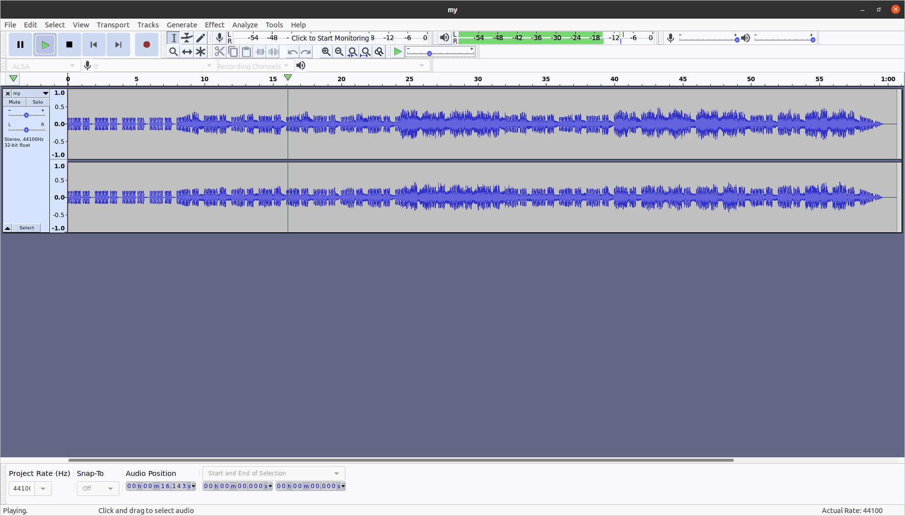

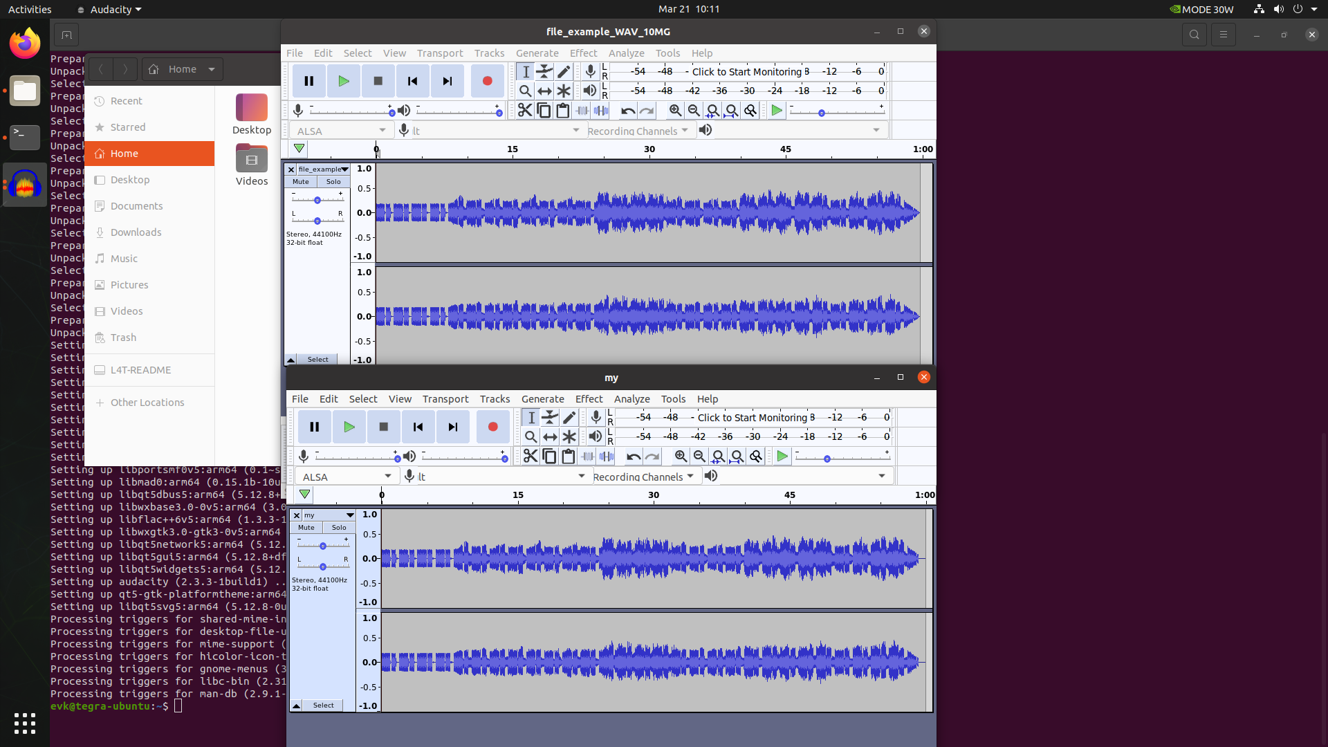

I have not yet connected the I2S lanes to the audio codec. Instead, I connected Dout to Din and probed the remaining signals per your suggestion.
