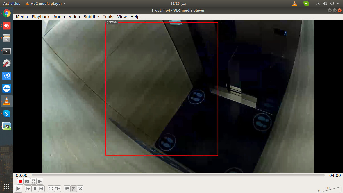

After full training, when I tested on videos via deep-stream app, My model is showing good result but no improvement in false positive(mostly when no object is present in the image). Below is some samples attached.
How about running tlt detectnet_v2 inference against the same images?
Same results (too many false positive).
