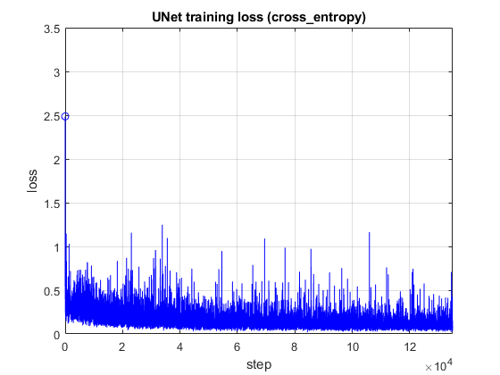

This is the training loss:
losses

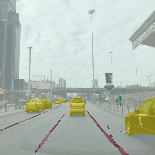

And this is the inference result:
Things to note:
  • Automatic mixed precision was not used
  • All images were png
  • All image aspect ratios matched the network input aspect ratio
  • All images actually had the same size as the network input, but I assume this is not necessary
Also, when resizing labels, it is important to make sure that the output is in single-channel format, and that the interpolation method is chosen such that no spurious labels are introduced. The above Python scripts does the resizing properly.
