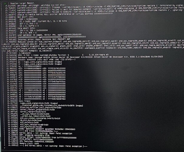

but there is a problem after all of things that need to done to the service be enable when i restart the jetson the jetson dosent boot completely it will restart it rapidly some times it will show me some message that show the kernel panic happened
[end kernel panic - not syncing: oops: fatal exception]
what is the problem ?? is it because of configs of my service or optee make systemd lock somehow to if any changing happend in systemd system sont boot up ??

im using kernel version is 5.10.104-tegra
jetpack 5.1 and l4t 35.2.1
and yes i rebuild atf and all binaries of optee sources need to be rebuild to new application work

as system dosnt boot to i be able copy the error logs i take a picture from monitor i hope be helpful

did you confirm this is reproduced with your own TA? since your failure looks like NULL pointer dereference from GPU side.
