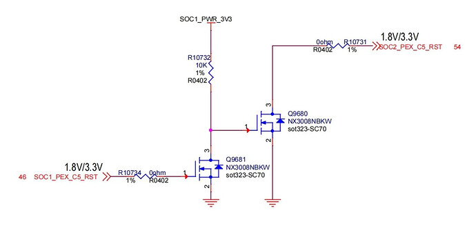

How is the wiring happened between the 2 Orin? Did you follow the design guide to make the cable?
only change C5 X8 to X4, and soc1 to soc2 PEX_L5_RST_N :
it’s already OK based on jetson 35.3.1, but failed on jetson 36.4.4
layout on one board, not use cable
I mean how did you connect the 2 Orin board here?
On what EP driver are you running there? Is that tegra vnet?
yes,follow the guide
it’s our owner designed carrier board, 2 orin module on one board
please make sure RP is boot up later than EP

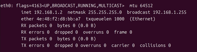

after debug, there is a great process, but also there are two issue:
1)ethernet name is different
2)RP eth device enumerate too slow
at EP side run
at RP side run “modprobe tegra_vnet”, lspci
img_v3_02vf_49ca41dd-93b8-4e4e-8667-acf388c7355g
ethernet name is different,
RP:
EP:
and RP ethernet show quickly but EP is very slow, about several minutes how to fix the delay on EP
–fixed
2)RP is very quick, EP eth device enumerate too slow
–not fixed, can you give any suggestion?
