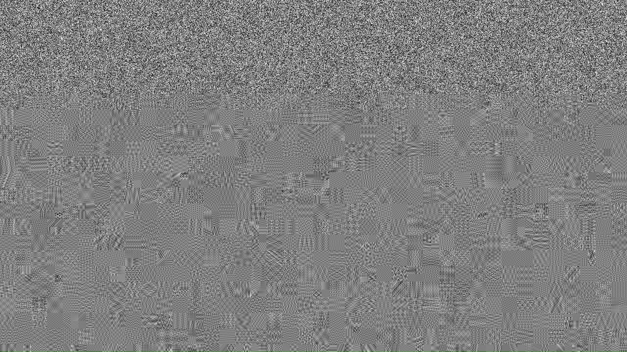

Please try with the YUVs generated with
gst-launch-1.0 videotestsrc num-buffers=300 pattern=1 ! 'video/x-raw,width=1280,height=720,format=I420' ! filesink location=a.yuv
i get a.yuv which has 300 frames.
then encode it as before, the encoded file size is the same too. both 7.2MB (7467157 Bytes)
such is the encode cmd:
./video_encode a.yuv 1280 720 H265 a_cbr.h265 -br 6000000 -rc cbr --report-metadata
./video_encode a.yuv 1280 720 H265 a_vbr.h265 -br 6000000 -rc vbr --report-metadata
(i add snapshot picture of the test video to the attachment)
Could you try ‘pattern=0’ also?
gst-launch-1.0 videotestsrc num-buffers=300 pattern=0 ! 'video/x-raw,width=1280,height=720,format=I420' ! filesink location=a.yuv
‘pattern=1’ may not be good for comparing cbr/vbr. This was my bad suggestion.
i have just tried pattern=0 and the result is the same.(8268029 bytes)
