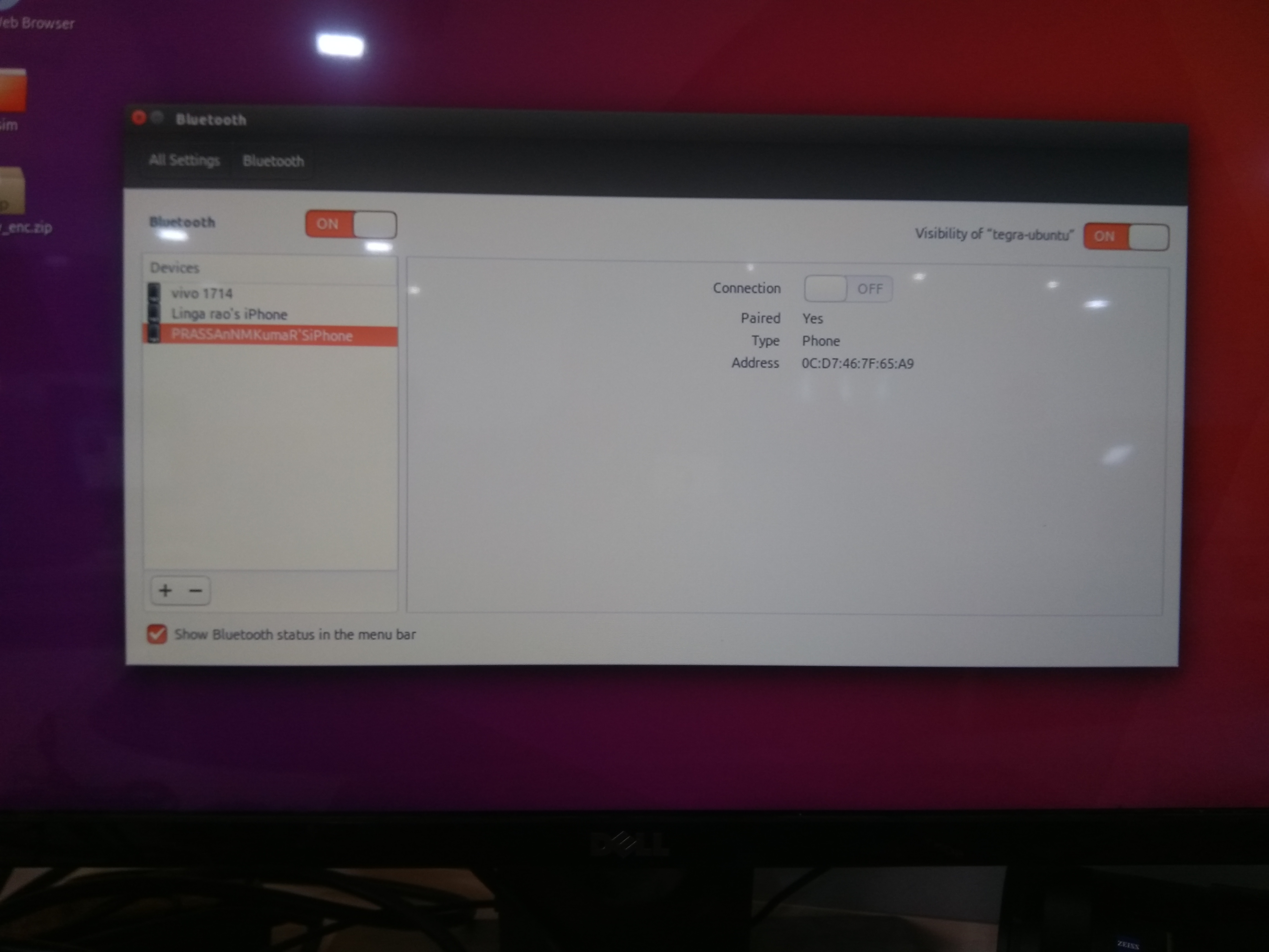

yeah its showing iphone and i have attached the pic of bluetooth setting of tegra for iphone 6s and android .
Hi meRaza,
Could you remove following parameters in /lib/systemd/system/bluetooth.service
-d --noplugin=audio,a2dp,avrcp
and below in /lib/systemd/system/ofono.service
,hfp_bluez5,hfp_bluez4,bluez5,bluez4,hfp_ag_bluez4,hfp_ag_bluez5 -d
Hi WayneWWWW,
After the above changes, its not detecting on either side (device and mobile ) both in android and iPhone
Hi meRaza,
Sorry for that. Could you only remove parameters in /lib/systemd/system/bluetooth.service and don’t modify ofono.service?
Hi meRaza,
I modified both files and now my iphone is able to see tegra.
