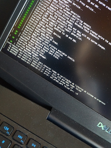

So, in the first time I rebooted it passed through the Dell loading screen, but once I put my password, screen went dark. I rebooted once again and then it frozen on dell loading. Again I rebooted and put the nomodeset, and even then system is freezing. I’m texting from my phone now. Also got this messages in one of the tries.
once again received this, guess it’s why it freezes, nothing more happens after this
Something is very wrong with your intel gpu or the driver for it. To get back into your system, try adding
modprobe.blacklist=i915 nomodeset
to the kernel command line.
It didn’t work
Does safe mode from grub still work?
